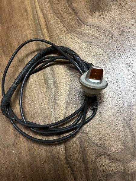

It is a 1971 Plymouth Satellite Sebring Plus. I took it apart and I'm going to try to upload a picture.
Quick BpBp I had put it back together, but it looked like the one that I need had threads at the bottom, and I'm not sure if the one in the picture that you sent does. I didn't pull the bulb out of the other piece as you can see in the picture so I'm not sure what the whole bulb looks like. Thanks for the reply.

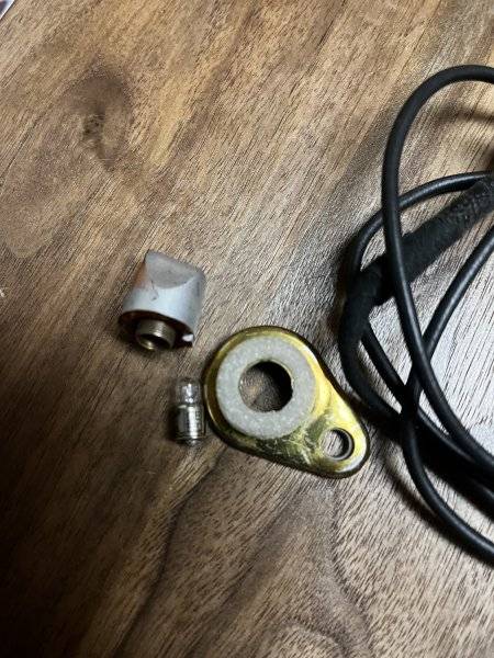

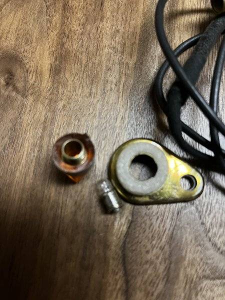

I have a few nos assemblies.. So I pulled this one apart for you. It’s a GE 330 bulb. And the threaded part is in your lens as seen in my photo below.

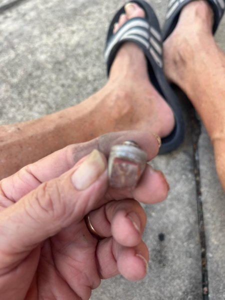

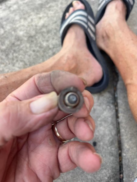

Oh I see, Thank you, How in the world do I pull the bulb out? Other than very carefully. Maybe needle nose pliers?
If you unscrewed it with out the cable being seized it should come out also. If you have a small pair of them you light be able to get a hold of it… I would put a drop of penetrating oil on it and let it sit before trying.
