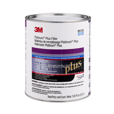

I have been using Evercoat Rage Gold for many years, but I have recently switched to 3M Platinum Plus. It is the best body filler I have used! It sands really nice! (even if it sits for a little while). Don't really know what the cost is exactly, but it's worth it! Just my 2 cents.
