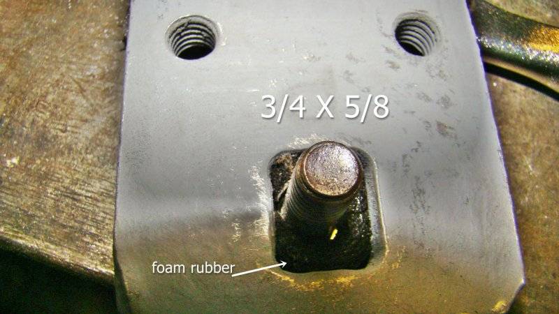

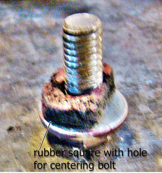

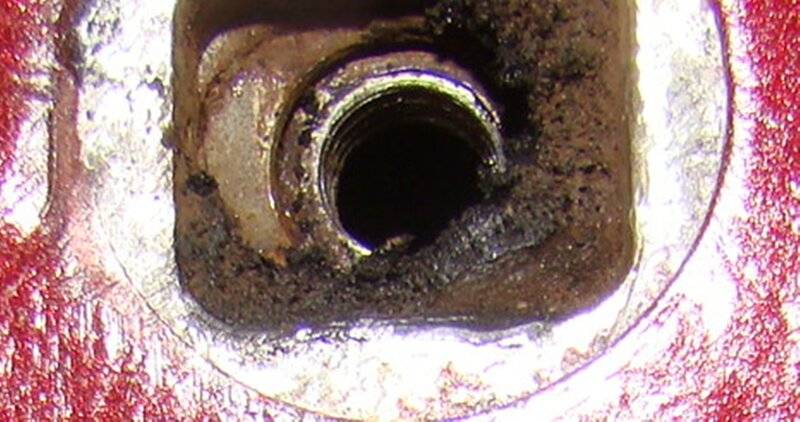

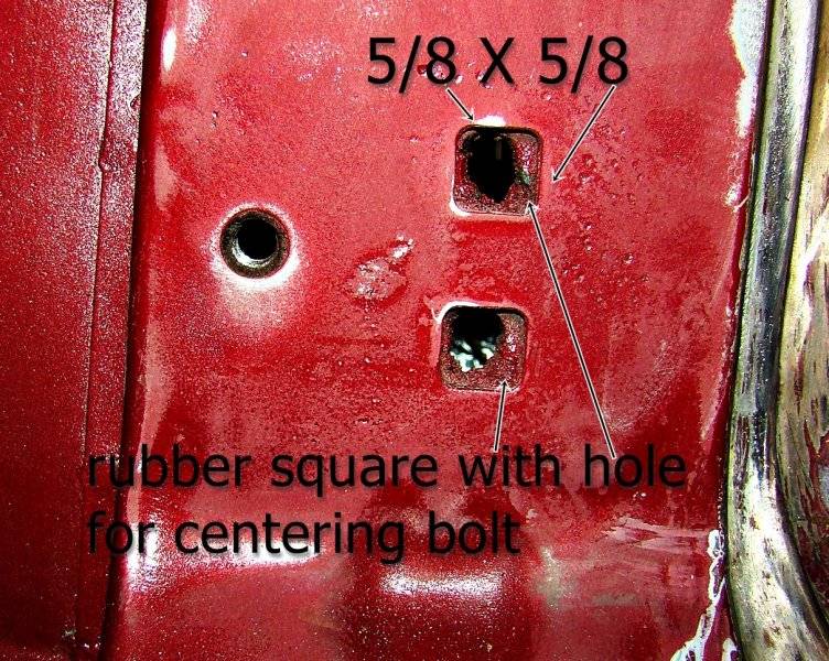

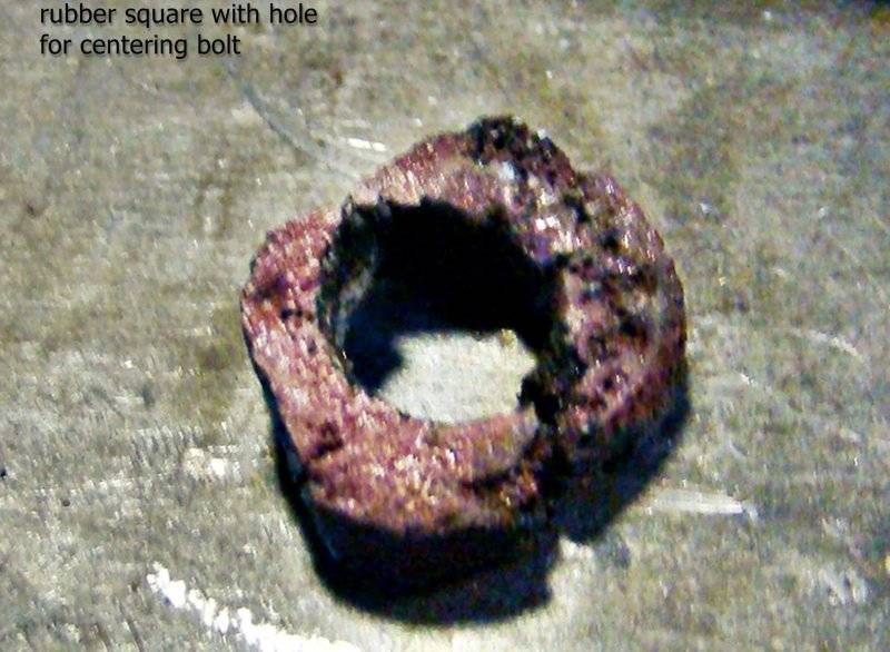

The thing is how to get the sealer in the square holes with bolt in place?
and not getting any sealer interfering with the bolt threads.
all Bolts were dead center of the square and rectangular holes on the body side hing placements when taken off... see pictures.
Possibly the square holes were fitted with oversized square foam rubber holding the bolts in dead center at factory for correct lineament of the hing to body?
when rubber is compressed seals the hole up
that is just assumption that has some merit from my prospective.
P
Possibly the square holes were fitted with oversized square rubbers holding the bolts in dead center at factory for correct lineament of the hing to body?
Thank you
View attachment 1168263 View attachment 1168264 View attachment 1168266 View attachment 1168267 View attachment 1168268
