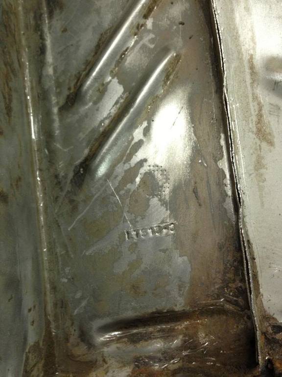

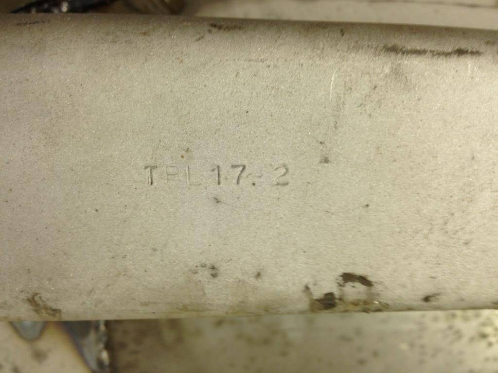

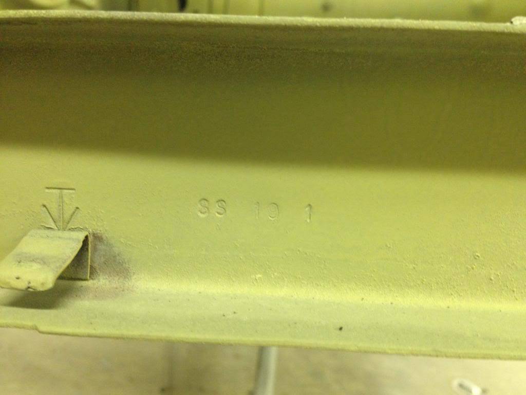

My 67 Satellite is up on the rotisserie now. I took some photos of various stampings / part numbers - as requested. Body has been media blasted and shot with primer.
Drivers side rear bumper bracket:
Radiator support:
Side of radiator support:
Plate under drivers seat - interior:
Package shelf:
Rear frame rail - drivers side:
Rear frame rail - passenger side:
Trunk floor passenger side:
Trunk floor drivers side - (was not media blasted - undercoating scraped:
