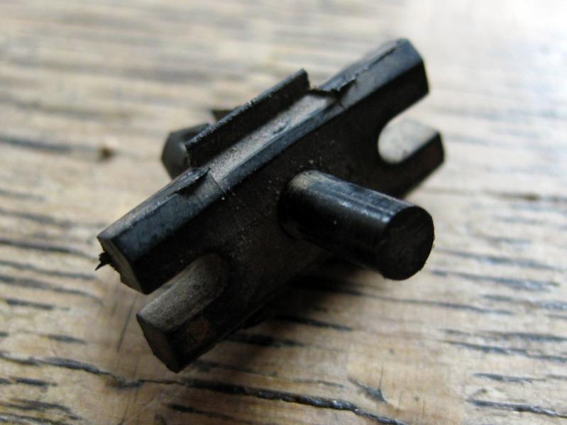

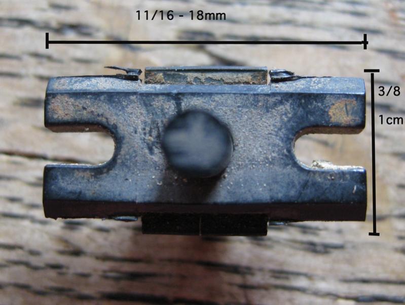

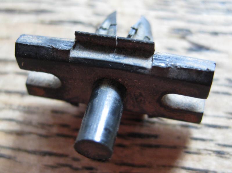

Here are some photos of the clips that held on the body trim from my 63 dodge wagon.
I've seen something similar from restoration specialties but I'm wondering if there is anything like a spring clip that would work instead or if anyone has any suggestions?

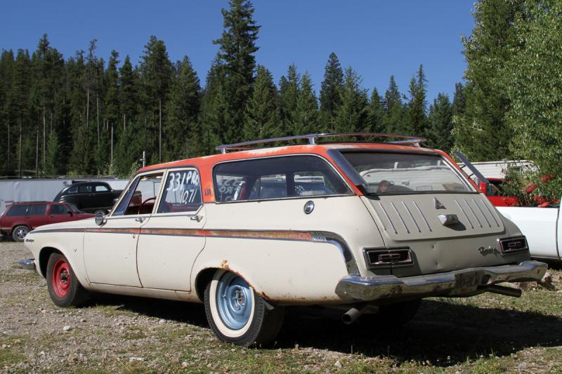

PS- does anybody have a back left outer tail light for the wagon shown?

I have those on my 64 Dodge.
On the end of each long trim piece (and along the length in a couple spots) there is a metal tab with a threaded post that slides into the trim and attaches with a nut on the backside of the body. Using more of those would be an alternative. I could see a 3/8" spring molding clip working if that's what you'd prefer.
Hey HitIt
Most of the plastic clips are missing the centre piece so I'm wondering what alternatives others have used....if any. The 3/8 spring clip might be good alternative.
Thanks
6001497 BODY MOULDING CLIP 64 DODGE SMALL
6001111 BODY MOULDING CLIP 64 DODGE
This is from r/t specialties. I ordered all new when I did my car and they were $$$. Hope this helps.
