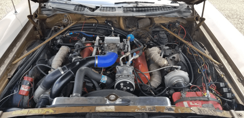

Been doing it for the last 5 years with one built as a 470.I run 2 of the ebay GT 45 knock-offs, but 1 would work for a 400 at modest power levels. Look up some of the Richard Holdener vids on Youtube, he has run that turbo on just about everything. Look for the vid where he ran twins on a 468 B.B.C., It was like 15 p.s.i. boost and only 6 lbs. back pressure in the exhaust. One will support just shy of 800 h.p., but becomes restrictive on the hot side on larger c.i. engines. I ran a single on the 383 I had in the car previously with good results. The 383 was a high milage, cast piston deal out of my old d.d. Newport. It lived with 15 lbs,20 degrees of timing, on 91 octane for 6 years. I still have it for a backup should a tragedy occur with the 470. The 470 is a Edelbrock head, 10:1 comp., half fill with a homemade 3/8" girdle on E-85. Just a late 1975 block, nothing special. Started with a 750d.p. blowthrough but have since gone to a Sniper set-up. I have had it as high as 17 lbs. of boost,but run it at about 12 most of the time. Don't get greedy trying to get an extra 5 h.p. cranking in more timing, and they will live a long happy life.
That’s fricken awesome, do you get a lot of lag or are they alright for your 470? I would prefer to run smaller twins rather than one for the ease of piping and how my engine bay is currently set up. If I kept it stock stroke or went 451 stroker would a 1.05 a/r likely be OK or should I think about going a little smaller? Also what kind of system are you running for water injection? Thanks for the info
