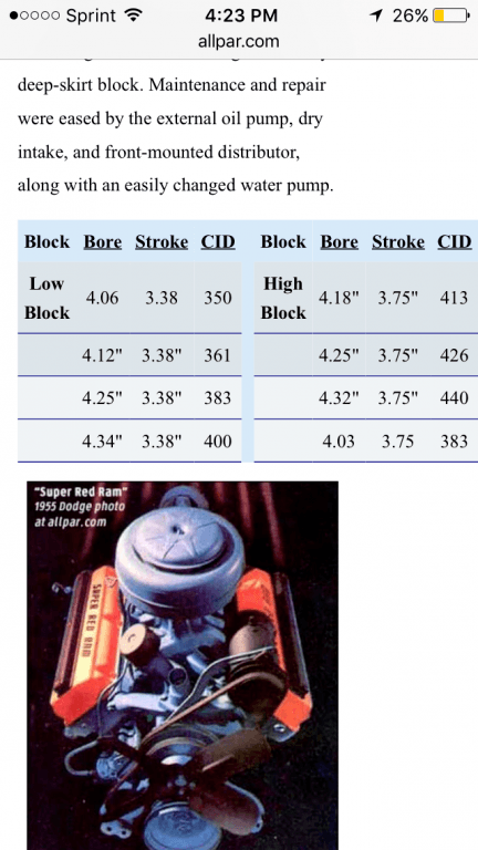

If you're .030 over you'll be at 4.15"
Besides deciding what CR (gasket thickness) you want, just go by the bore size offers the gasket companies have. You just don't want any overhang on the bore. .030 isn't that much, .015 per side...can even see if stock gasket hole size will work.
Yea...Cometic recommends their 4.25 gaskets for my 4.15 bore. May just go with felpros again....gonna retorque

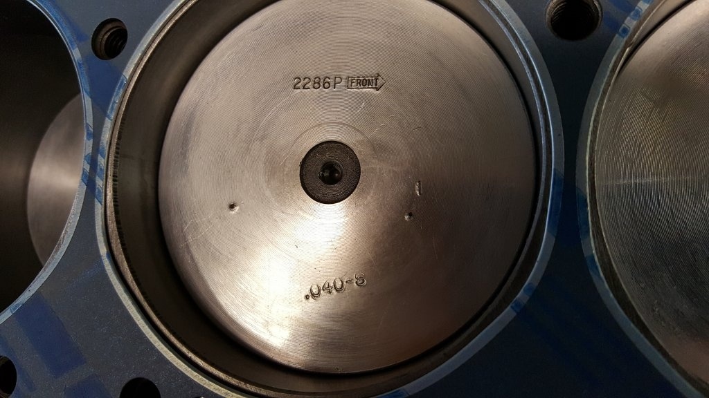

I'm .040 over on my 440. Used Felpro 8519pt1 measured fine on head and cylinder clearance.
