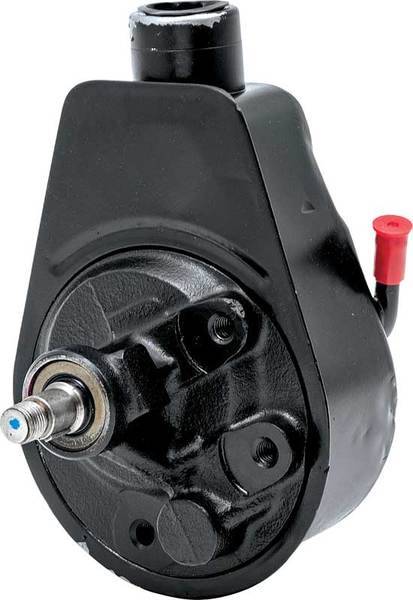

Like many before me, I'm installing a Borgeson steering box into my '68 Coronet. Thing is, am struggling to find clear info on what particular pump is needed or optimal with this unit. I've gone down a few rabbit holes about pressures etc. which is more involved than I want to get - I basically want to know what works. I'm not sure what's on my car now (Federal, Thompson or otherwise) but it's not a ham can reservoir Saginaw which everyone seems to be using.
One thing I'm not sure about is why the Saginaw is the go-to pump choice. Is there a specific application the pump should be sourced from? Can anyone give me a specific reason not to use my existing (non-Saginaw) pump and lines?

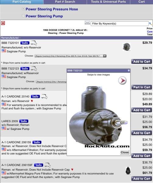

i used this one from rockauto and no issues with my Borgeson. i needed to move the pulley to this new pump. i installed a small in-line fluid cooler while i was doing the job
a great upgrade and handles awesome
