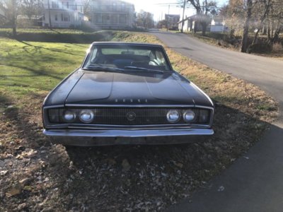

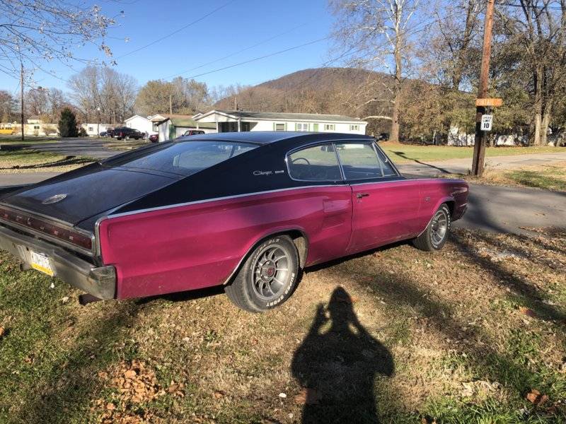

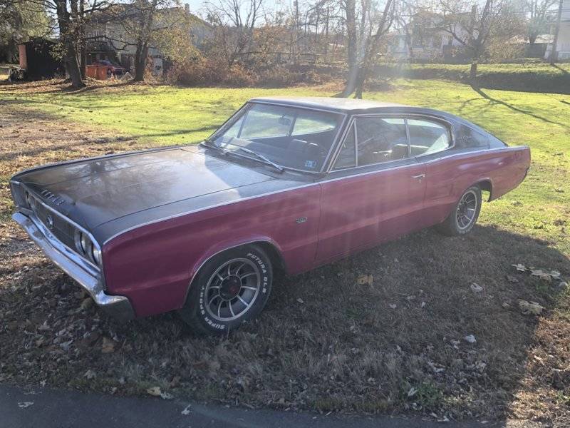

Couple pics of the car, and the uhaul roadside assistance guy who swapped a new tire on their trailer. Got a full debead about 2 blocks from loading the car up.

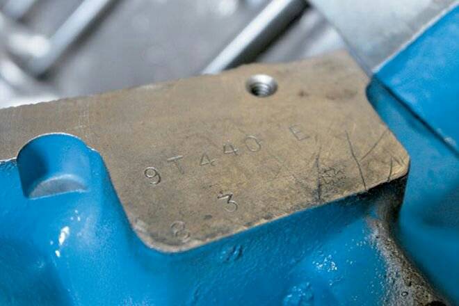

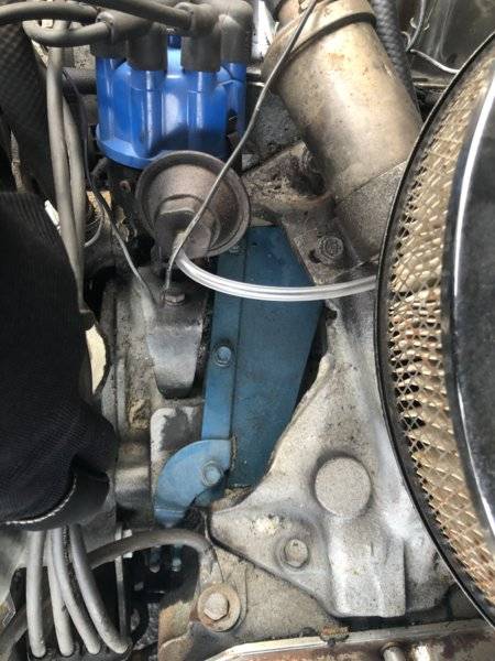

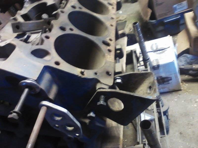

So it says G44 that I can read attached the picture is the pad.

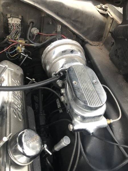

drum all around and attached is a pic of the master and booster

So it says G44 that can be read attached the picture is the pad.

If you can see the G and 44 without removing anything to look at the full pad you have a 71 440 R/B engine. Removing the sparkplug wire loom and reading the entire pad will give you the build date of the engine and if its a HP engine or not and possibly other information.
You said the brakes are 4 wheel drum, so the first thing I would check would be the master cylinder bore size, compared to what a stock power drum master cylinder is supposed to be in 66. Also I would check that the brake pedal has the correct linkage and throw for the new booster master cylinder application. The biggest help you can get is a 66 service manual. Either download it here or buy a copy. Personally I like to have the book in front of me.

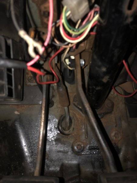

Shifter linkage I have a feeling just needs tightened a bad trans usually is always bad for me but the super inconsistent behavior has me thinking something isn’t tightened or adjusted right. The shifter has a hard time finding neutral also

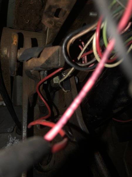

That is an aftermarket power brake booster set up - doesn't seem to have the factory bell crank set up I usually see - which isn't a deal breaker but the hard pedal is a sign of low vaccum - I would put a gauge on it and see what the engine it making and go from there. Start eliminating things as you go.
Also - it looks like your clutch pedal is not returning all the way - the ear on the pedal should be hitting a small rubber bumper on the pedal bracket - so it doesnt look properly adjusted to me - you can lift the pedal slightly and the overcenter spring will pull it up up to the "normal" location it should be - this adjustment can then be taken up at the clutch fork under the car.

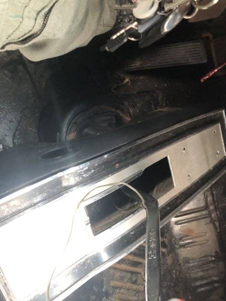

If you can get under there take a photo of the shifter mechanism on the transmission - we should be able to tell you if it's a hurt unit - they offer a rebuild service of you can remove it, clean and regrease it yourself - it's fairly straight forward unless something it damaged. Also - I have seen shifter rods have quite a bit of play in them on the shifter itself - you can put a band-air on them bu enduring there are washers to take up the slop between the cotter pins and the shifter levers.... if you just have a cotter pin the rods can have a lot of side to side movement which allows for a sloppy feel at times.
It sounds like you have a sloppy shifter that may not be adjusted properly and simply not used to the A833 gear whine. Reverse is also kind of difficult compared to newer transmissions so I dont honestly know what to tell you on that - there may not be anything seriously wrong with the transmission - may just need to get used to the "older stuff"

I’ll look into checking vacuum tomorrow, need to retune the carb as its horrendously rich. There is also a exhaust manifold leak I’m gonna hopefully correct as well.
I’ll see about snapping some pics of the shifter linkage. I have driven a number of m20/m21 cars and this is hard to talk over gear whine, it’s very inconsistent, and reverse is easy enough to go in I suppose, both hands pulling to yank out. I feel like that is more than just old stuff being old.
