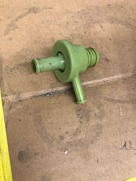

Hi Everyone,
This is for a 1970 Superbird so needs the extra nipple for the vacuum headlights.
I'm hoping you'll be able to help me here once again. I'm looking in the David Wise restoration book and not finding complete info on the vacuum connector for the brake booster. I'm just doing some final details on my restoration and have a couple of questions here as follows;
#1) Is the attached vacuum connector the correct one? If not do you know where to get an
original or authentic reproduction?
#2) What color is the original one supposed to be?
#3) Finally does it get a hose clamp (the standard two prong factory one). I'm assuming yes here but just double checking.

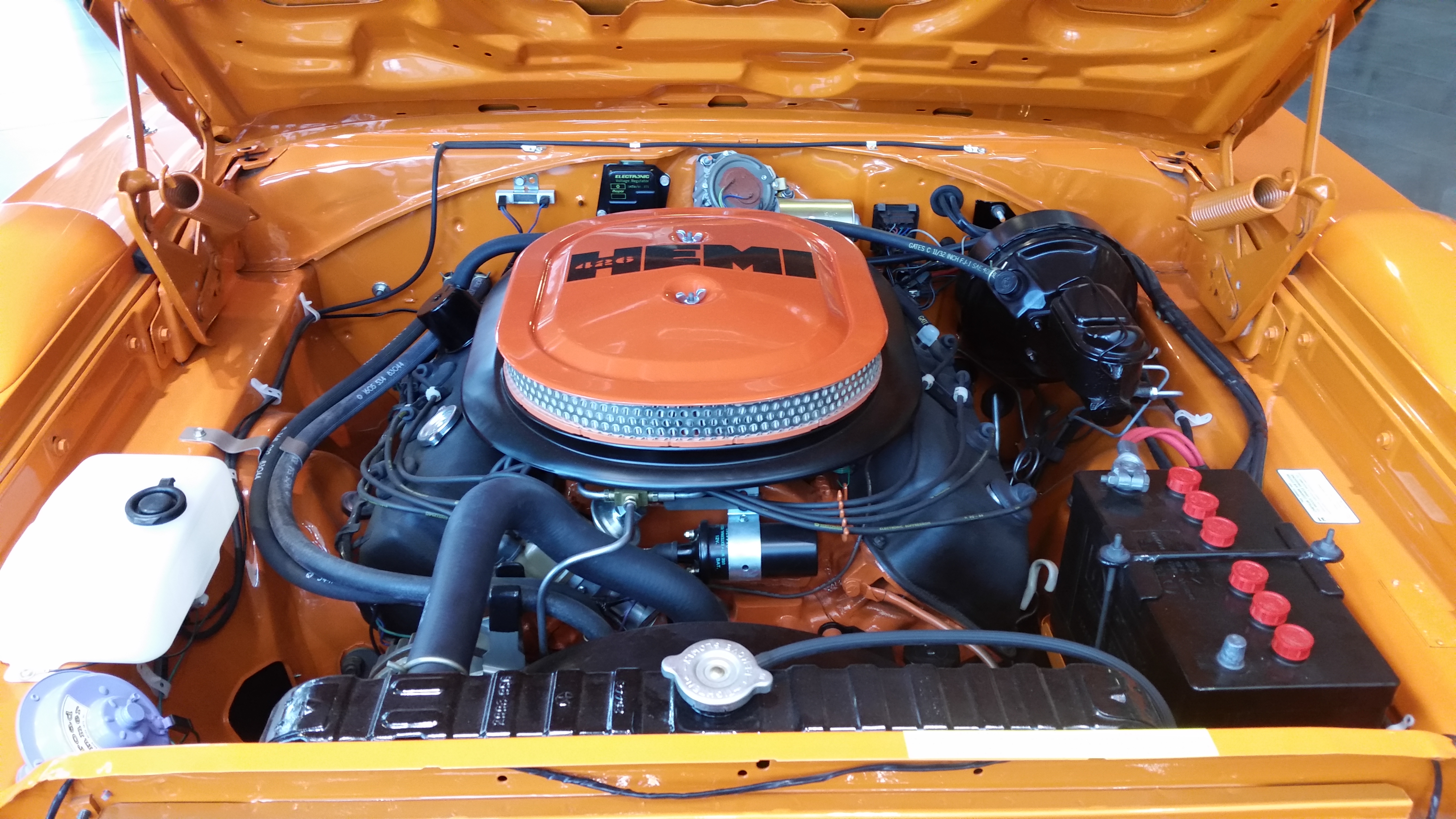

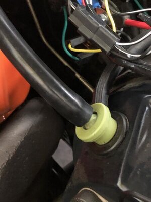

2020-06-15 Booster Vacuum connector on car.jpg 2020-06-15 Booster Vacuum connector.jpg
I am the second owner and the one that did the restoration. Original booster, vacuum fitting and clamps.

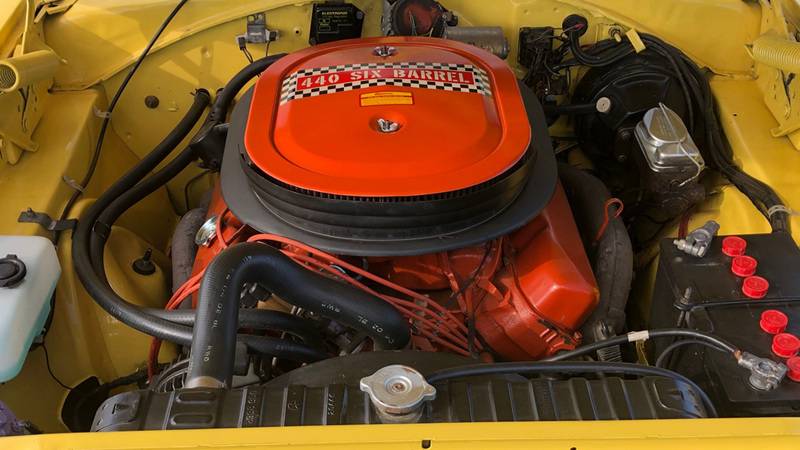

Found this picture on the web.. Not sure it helps but its not green in this picture. Also looks to be a single line.

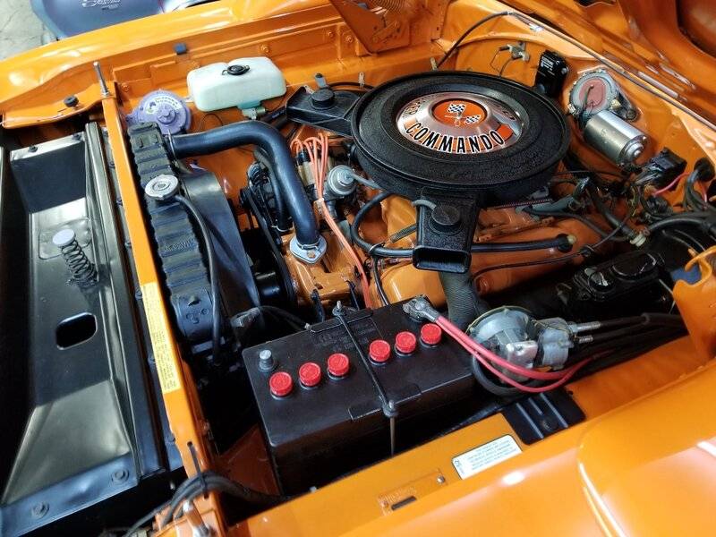

Here is another.
