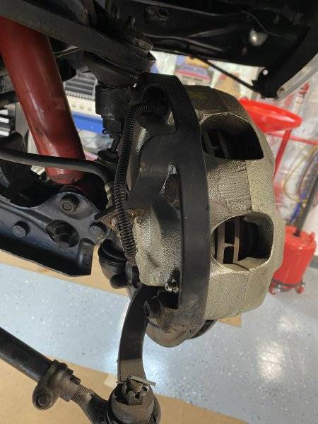

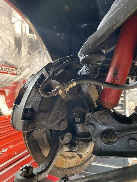

Working on a new project. 67 GTX with factory disc. When I looked at the position of the bleeder screws they were both on the bottom. Can this be correct?
Try switching the calipers side to side. Hose brackets, steel lines, and all.
