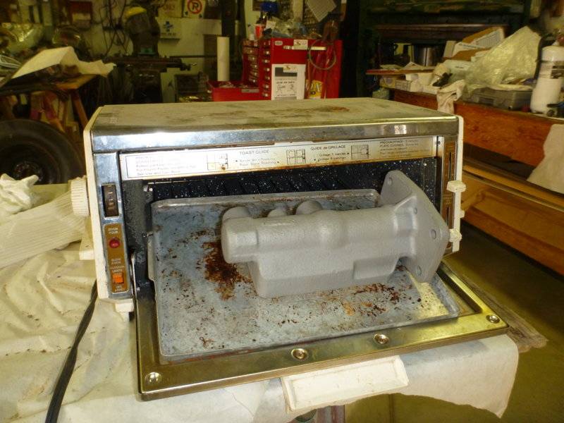

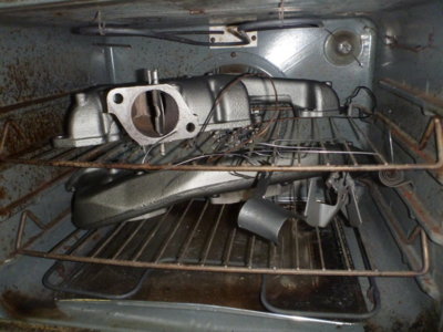

This is where a cheap toaster oven from GoodWill comes in handy. Can set it outside and bake away without having to suffer the wrath of the Mrs.
I just stole her entire stove and took to the shop... of course after she caught me using it in the house first, so I bought her the new two door that she always wanted! Also use a cheap toaster oven, as noted above, for small parts...
