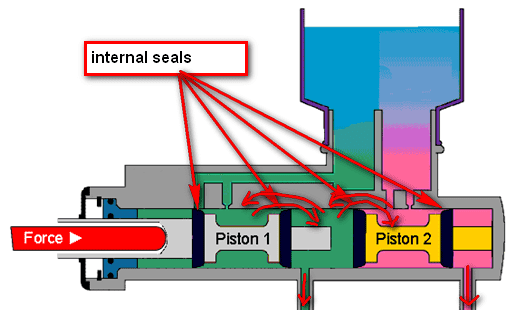

Your master cylinder is a brake cylinder in reverse - it exerts the pressure rather that receiving it. For it to fail this way only two things could have occured: 1- it was not exerting forward pressure which means the seals flipped or the seals somehow were not hugging the wall of the bore or the stem of the master shaft, and, 2- whatever fluid it took in from the reservoir to exert pressure, it put right back in the bowl when the pedal was pushed. In other words, instead of the fluid going down the lines it headed right back in the bowl. All that's left is the mechanical side of things but you've already proven that's not the issue.

What would cause this? Anything I can do with the MC off the car to test if it's doing it?

The rearmost cup is not the cup that exerts pressure, rather it sucks the fluid into the piston and acts as an end seal. If any of the cups forward of this one failed ( rolled, folded back at the outer lip) you won't have fluid out the back because there's no pressure present here to cause a leak. When you pulled the piston out, the cups may have folded back to their normal position as they dragged against the piston wall. If there are check balls built into the casting, the fluid probably just moved back and forth from the piston to the bowl if the balls weren't seating properly due to debris. That's why the bowl was still full.

One of these seems to be the most likely cause. I can't see the check balls if it has them, but I wondered if the seals had somehow gotten out of position when he was applying the brake. The sudden pressure loss after working great for 600 miles means something changed very quickly.
