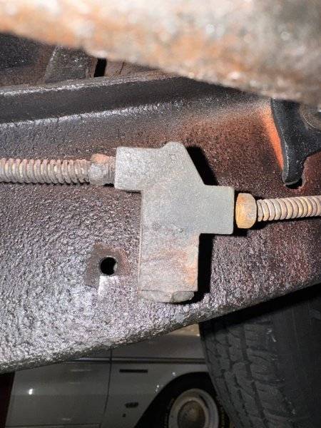

I noticed a rattle under the drivers side floor on my Superbird, noticed this brake line brass union that looks like it use to have a bracket holding it in place.
Anyone have any pictures of their rear brake line in this area?
Thanks in advance

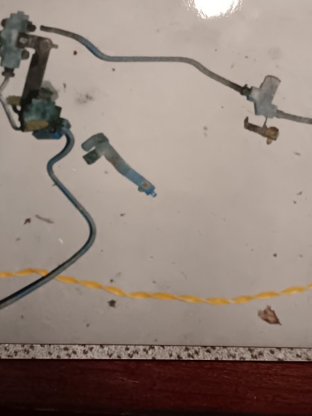

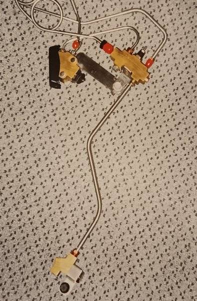

From my Superbird restoration back in the 90's. First pic is the original distribution pieces. 2nd is a close up, with the retainer strap partially rusted away. I fabricated one from a piece of thin metal. It is shown in the last two pictures. The strap is squared-off around the block and bolted to the frame with the (original) fastener in the last picture.
