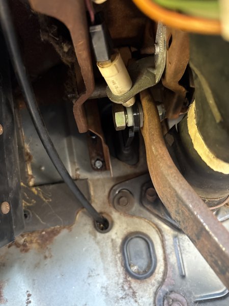

I noticed my 67 Chargers brake pedal arm is not adjustable. Would this be good to lower the brake pedal? It looks like to me the original brake pedal hardware was probably used when the brakes were updated to power disc.
The brake light switch is hanging up the arm sometimes. Does it look like the manual brake setup was used on the power brake setup?
