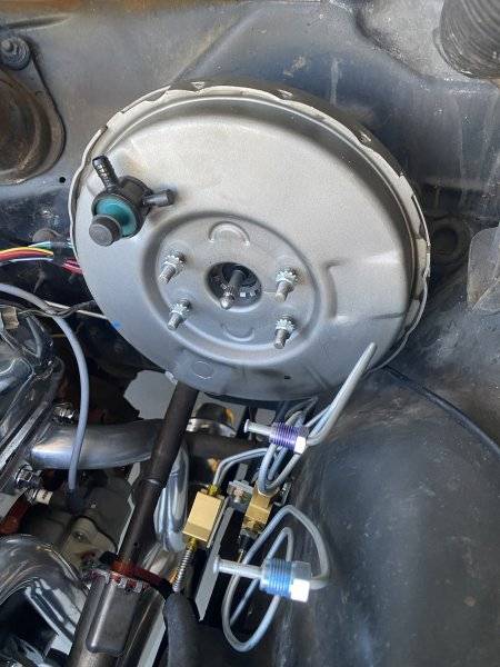

So I haven't been on for a while. Have been muddling through my resoration with some success. I cant seem to figure out why my brake pedal will not come back up by itself. Even with grabbing the pedal with my hand and pushing it up, it struggles to come up. I had the master cylinder on and the spring in the master was not strong enough to force the pedal up. I think the new old stock booster is binding. Has any body out there ran into this problem. Any feed back would be appreciated. Linkage for pedal is not binding was installed correctly per factory service manual... 1971 Charger SE, 383 magnum, 4 speed. The car did not come with power disc brakes, but the conversion was done with new pedal bracket for power brakes.
Booster is bad. It is not the job of the master cylinder to return the booster.

Have you tried putting a hose from the check valve on the booster to the intake so it pulls vacuum?
yes, I have put vacuum to the booster still no change in pedal
sounds like a plan. sad part is the booster is brand new
Will they rebuild an aftermarket,,,It is a Cardone

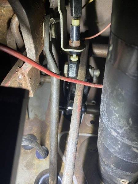

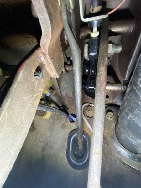

You should probably disassemble all the pedal linkage and double check that nothing can bind... The pivot with a nut and bolt needs a tube inside so it can't collapse the pedal hanger bracket.. The other pivot has a shaft that floats in the hanger bracket at one end and the nut clamps the shaft... Also the booster and dogbone should have internal bushings that prevent the link bracket collapsing and clamping on either end..
Your Cardone booster is a rebuilt OE unit but I've had issues with Cardone boosters in the past.... Booster Dewey has a very good rep...
OK, thank you I will call them tomorrow. I will check the linkage again. But I did put it all together per the FSM...thanks everybody for all the help
On the linkage there are a lot of details the manual really doesn't touch on... Just pay close attention to each pivot..
