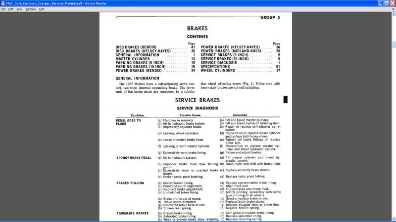

does this help?
Service manual didn't help much. Any other ideas ?????
