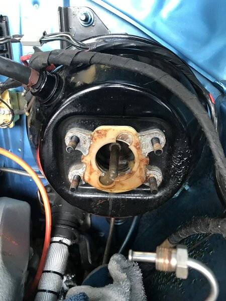

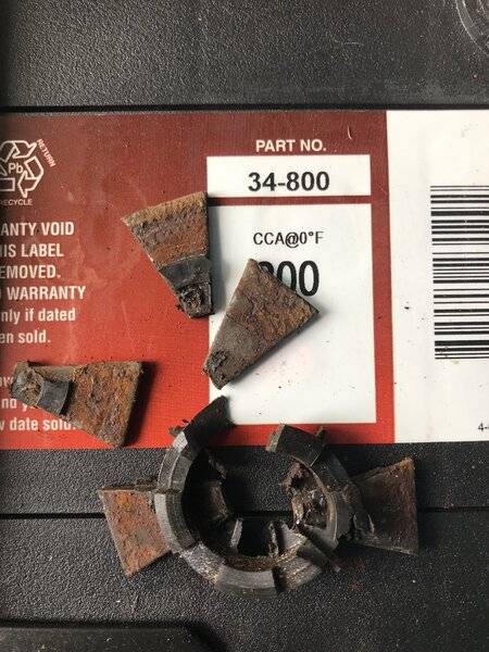

Well after checking all the pedal linkage and finding in good order, I pull the MC, and looking in the booster I found this mess of pieces, and the push rod flopping about.
New booster on order with my favorite parts store New-5 Auto, he located one and will have Wednesday.
I have never had a more exhausting and cuss filled morning working on getting those 4 bolts out under the dash, drivers seat is coming out for the re-install, lol
