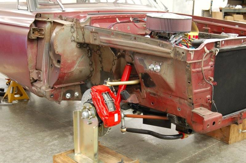

There are lots of different brake options for Mopar cars. Doctor Diff has some good kits, Baer has good stuff, etc. I used 13 inch Baer rotors with Porsche calipers on my Coronet. Stops great but probably overkill for most folks. The factory 11.75 setup should work for any street car, if you're cooking the 11.75 rotors then you'll need to step up to the big boy stuff.
