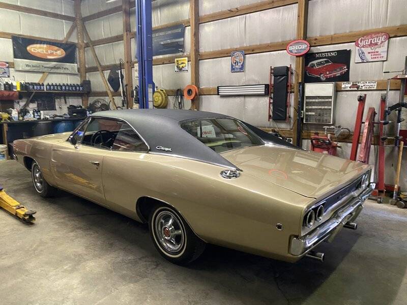

Hey,
I am going to convert my 68 charger from front drum to power disc.
What kit do you recommend?
I would like to use Magnum 500 wheels.
*What tire sizes can I use on the front and rear?

I have 275/60/15 on the back of both of my Chargers, BFG Radial TA on the 70 and Cooper Cobra on the 68 both on 8" rims w/ 4 1/2 backspace. 235/60/15 on 7" rims are nice on the front. Chargers will take a lot of tire!
Some recommend 8”in front and back. Others say 7”on the front and 8” on the back. Thoughts?
I have the original hub caps currently.
