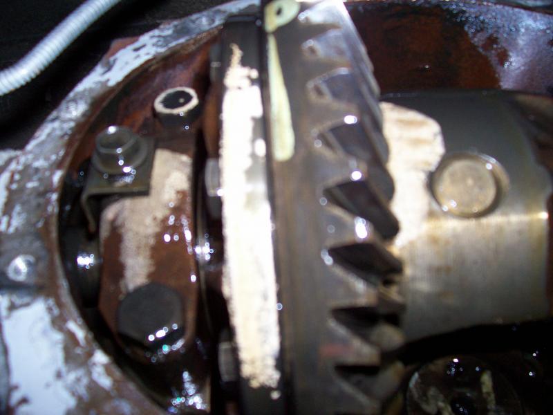

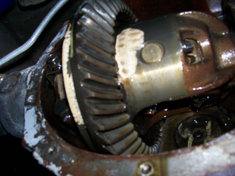

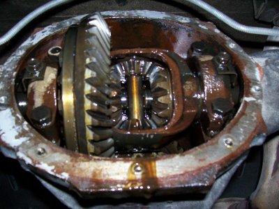

Here are a couple pics.
Does that axle use c clips to retain the axles?
I'm in middle of taking a closer look now. C clips. When I play with the outside end of the axle and look inside the diff and observe the inside end of the axle there is no free play in any direction when I wiggle or turn it. Axles are not broken. No grinding, clunking. In other words, I wiggle one end with my hand, the other end moves exactly the same.

Ok axle's are out and they ain't broken. None of the splines are stripped, they look good. The spider gears look ok too but maybe a little worse for wear, the splines inside the spider gears look A-OK. Outer wheels bearings look good. The carrier is coming out tomorrow.
