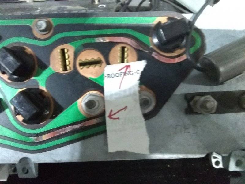

Thanks so much for the quick replies. I really appreciate all the help I've found here.The car is a '69 Satellite Sport. Pic is hopefully attached.

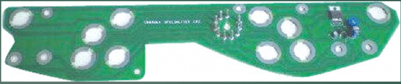

If you can find a nice board replace it. If it's out do it right.
Get the updated board sir ….vastly superior

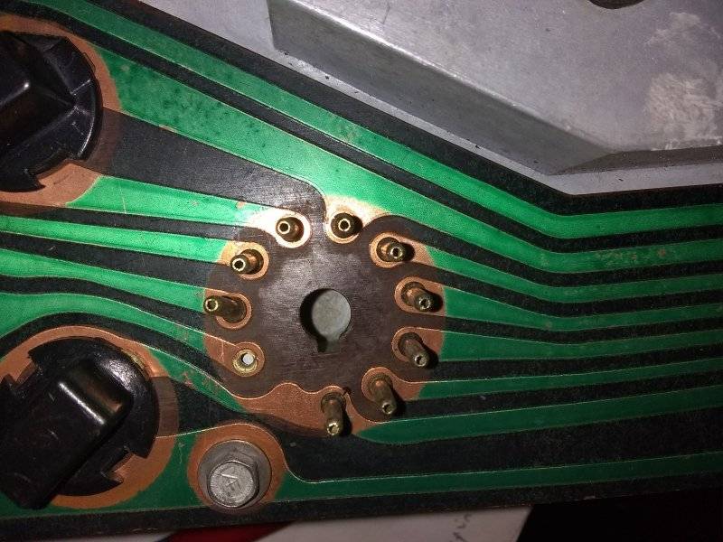

That looks like a simple fix. Tin the board first but don't fill the hole! Heat the pin up and wipe off the old solder with a damp tissue so you're working with clean solder. Insert the pin and solder it. Don't spend to much time with the soldering iron on there or the foil will detach from the board and then you're screwed.
I went to Bristol this evening to visit my daughter as her husband is my solder guy. He noticed the burn at the bottom and other one was hidden by limiter. Looks like I'm a little too rough on the equipment. A new board is in my future. Thanks to each of you for your help.
