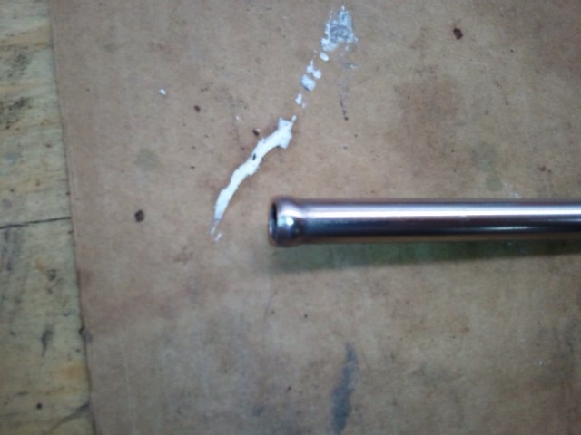

image.jpg.
How but one like this thats a little more rounded
