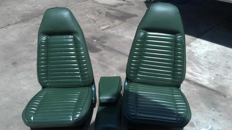

These are my redone 72 deluxe interior seats for my 72 RR in black. Excuse the dust, they are in storage because the car is far from ready for them.
Joe

wow!!!! them are sweet !!!! now im rely excited to get mine done !!! great job and thanks once again .. Im ordering this morning thanks to your help Joe

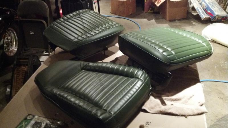

seats are coming together nicely .. more pictures and updates by the week end very excited !!! :headbang:

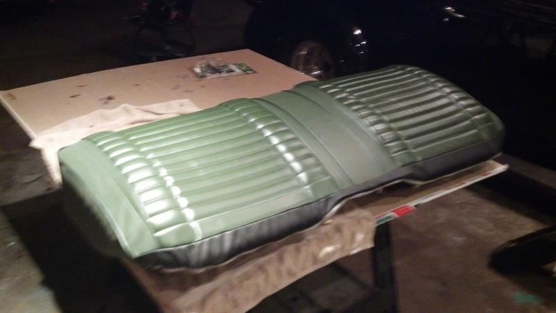

Back seats

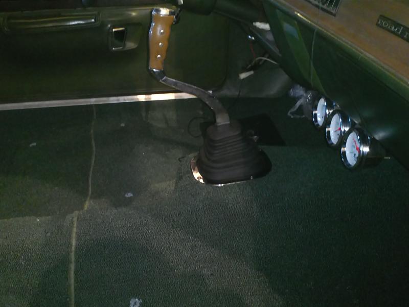

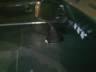

seats are done and will go in tomorrow ... nothing ever goes together as easy as it comes apart but we are getting there ...
will be driveing this week

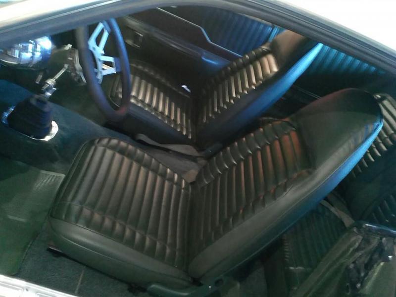

seats are in and looks pretty darn good for a poor boy
