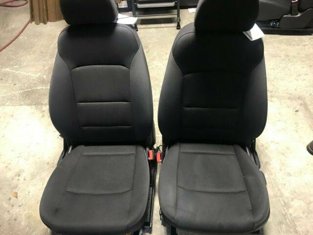

A friend picked up some 2018 Malibu seats for the 49 Check they are building at the Autorama swap meet for $20. Driver is electric, the passenger is not.They elevate pretty high, probably 3-4".
They do have side airbags but won't be connected. You could probably pick them up pretty cheap at a wrecking yard.
Very supportive, have bolsters and pretty comfortable. They are easier to get in and out than my Procars.
