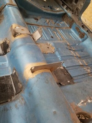

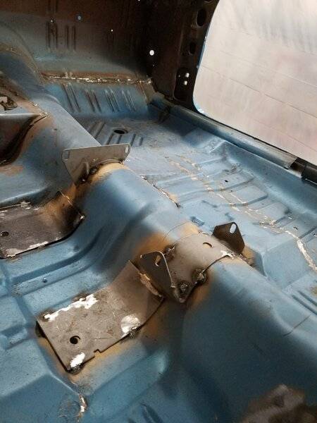

Here are some pics of brackets I just welded in my 69 RR as well as attached to a spare seat I have. I believe these are the same as your Charger.
20210221_072546.jpg 20210221_072606.jpg 20210221_072650.jpg 20210221_072703.jpg
Thank you for the pictures. Those are unique brackets. My buddy seat frame wraps all around the bottom and has 4 factory drilled holes that would appear to be bolted to a bracket over the tunnel. I will take a picture of it and post later this morning.

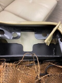

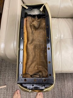

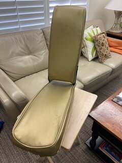

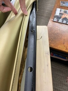

This is my buddy seat. You can see the frame around the bottom of mine has the holes all around. I see one bolt opening on each side toward the rear. See attached photos. It looks like your brackets have the fasteners attached to the side of your buddy seat. Any comments are welcome. Thank you.
Gold buddy seat.JPG Full bottom frame of buddy seat.JPG Side frame opening on  buddy seat.JPG buddy seat open.JPG rear frame of buddy seat.JPG
View attachment 1075200 View attachment 1075201 View attachment 1075202 View attachment 1075203 View attachment 1075204
Yours is the same as the one I pictured, the holes on the bottom are for the hog rings to go through, mine has them as well. You need the same mounts as I showed....
