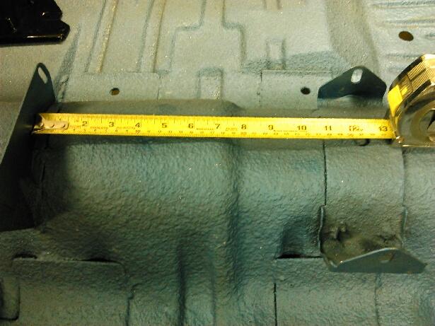

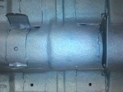

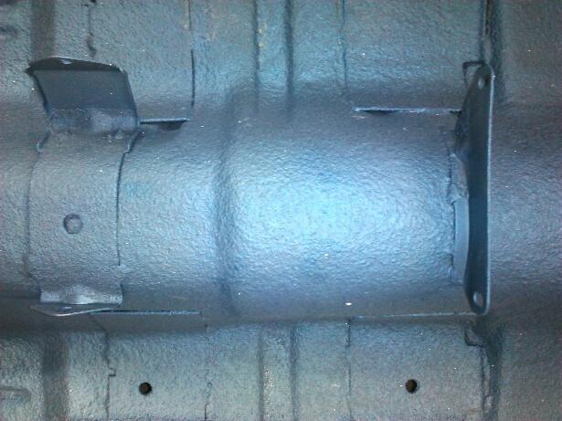

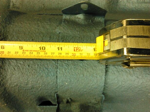

Anyone have a car with buddy seat.. That has some pics or any info on where to weld in brackets for the seat 1969 plymouth gtx
I will try to get you some pics, measurements tonight!
Ultramag 870, those kick like a mule with 3" deer slugs!
I can take some also this evening.
I can take some pic's also and measurements if you like.
Not sure if this is from a 69 or 70 but I used it as a guideline. Just to be sure, you should line up your buddy seat with your buckets too. View attachment 270003
So I would use a level to help locate the front bracket at 10 15/16 from front floor pan seam. Tack that in place. then I had the rear bracket on the buddy seat and bolted it to the front bracket to locate it to tack the rear bracket on. My car originally had the buddy seat but someone removed it through the years. The welds were still there so I knew where to put it back to. Hope this helps. Just make sure you can unbolt then get it bolted back in after welding.
Bracket with ears goes to rear.
obvious by the pic's all spot on. I will mention in the car the back of the buddy seat should line up very close to the backs of the bucket seat frame (not the front). approximately 5.5" spacing on each side of the buckets too.
