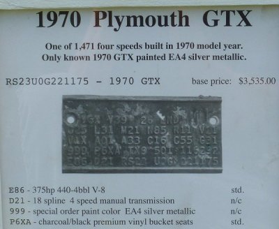

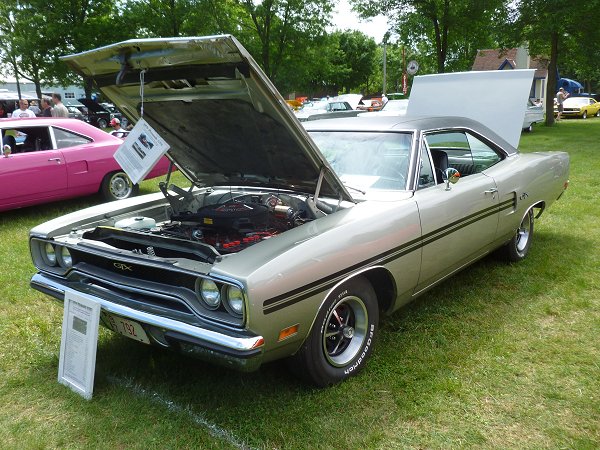

EA4 Silver was not a standard color for 70. Therefore any EA4 car would code 999.
I missed two of the '70 Hi Impacts: In Violet F7 and Bahama Yellow E5. (Curious Yellow Y3 is in '71)
A4 Silver Poly was a standard color for 1970 Plymouth.
EA4 Silver Metallic (sometimes called Platinum) was not.
Why would a color with an assigned number code in the Chrysler system be sprayed on a Plymouth and also re-coded as 999? I'm not saying I know, I'm confused. Just pointing out that 999 was for "one-off" colors, NOA (Not Otherwise Available), and non-Chrysler colors.
So, if for example, EA4 was available on the Imperial (and I think it was) then why use 999 to track the color and not just use EA4?
The older I get the less I know.:icon_scratch:
I just saw that the tag you posted for the GTX shows it's a St. Louis build. That might be one answer, that STL was more active using 999 on their sheets and tags than other factories.
At least in '68 cars I've met many more 999 tags from STL than all other factories (though always rare). Were Imperials produced in STL in '70? If not, and EA4 was an Imperial color, then STL used 999 for the Silver Metallic?
Just one possibility.

Thanks for the info. My fender tag reads like this
26124 183159
122 083 676
C250 26
999 V88 N96
999 P6xa TX9 C12 J01084
E87 D21 RM23 VOA 180480
I can figure out most of the codes but don't know what these code are
26124 183159 C250 V88 C12 J01084 VOA. I know the V is 440+6 the 0 is 70 but don't know what plant is A.
Thanks for your time and assistance.
A is Lynch Road
Road Runners (68-70) were only built at Lynch, St. Louis and LA.
26= gate
124= base
183150=sequence
All are related to the body in white (initial assembling the different unibody components)
C250= the actual paint color code. Is the car now something like Limelight? If you look at an unpainted area of the car, it is a light blue?
V88= stripe delete code.
C12 = scheduled production date of November 12, 1969
J01084 = Vehicle order number.
