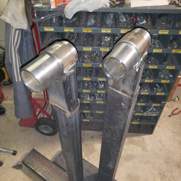

I've got about 12" of room to make it fit and be able to close the shop door . . . so the plans are to use 3X for the uprights, and 3X for the spinning supports . . . do that on both sides and you have 12" . . . so it's going to be tight ( and fun ? ? )

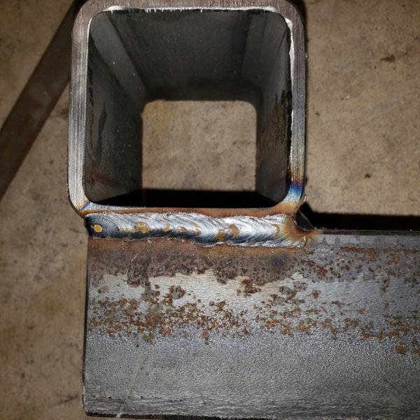

First of all - ALL of these scraps are drops from the steel supplier - find it much cheaper that way to build this stuff . . .

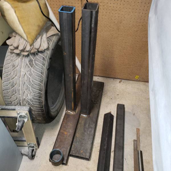

Here's the bottom parts of the (2) supports . . . 3 x 3 on one, 3 x 4 on the other . . .

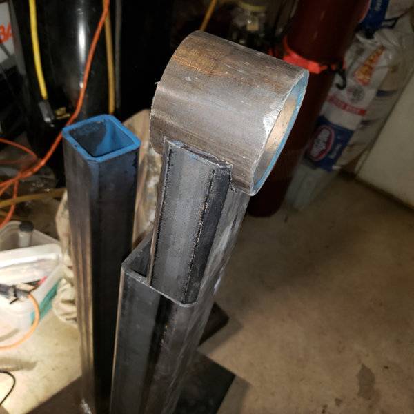

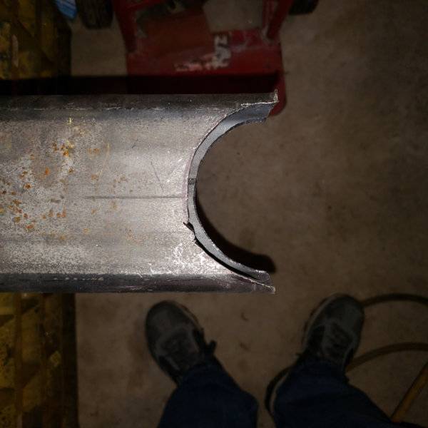

To hold the round tube on top of the channel, cut and grind the metal to accept the tube . . .
So it'll fit like this . . . I'm sure the welding will hide the gaps and give room for the weld metal too . . .

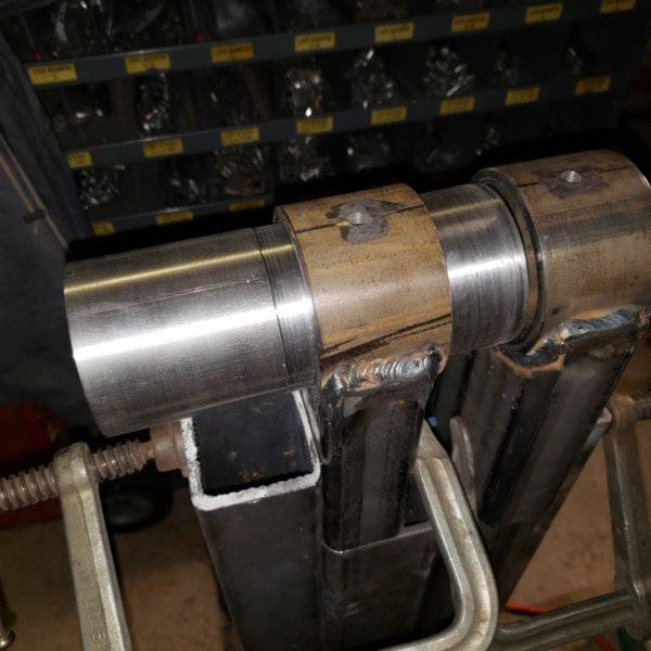

Here's the plan . . . but they cut the tubes on top to 3", and I decide to drop them down to 2 1/4" - to have room to put a bolt on the back of the inside tube . . .

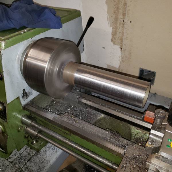

Tossed them on the lathe and got them milled down and cleaned up . . .
Now to get this all welded together - then work on the spinning support brackets . . .
Sure hope that I can make all of this work out . . . WANT to have it on the rotisserie before the new year . . . . ( that's the plan . . . )

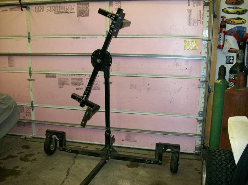

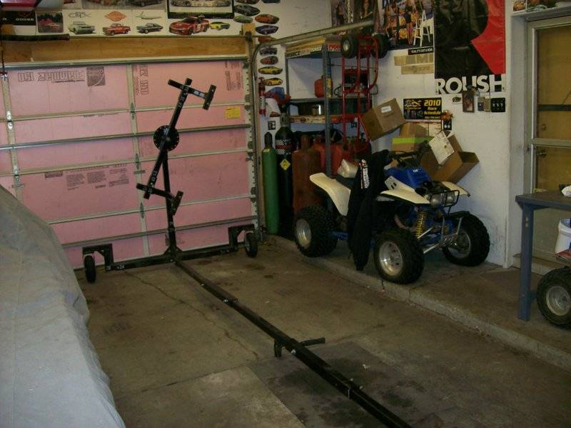

Looks like a good start, pretty sure I made mine out of 3X as well? To bad it's on loan or I'd snap a few pictures for you.
You already have it but 3X3 is overkill. Also, instead of cutting half round holes I use a piece of channel on top with the round tube sitting in the channel.

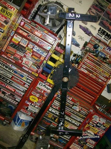

I built two of them over the years. The first one was sold of with a Project Challenger. The second one has been on loan and
has a couple of cars on it & a truck cab & bed. I just finally got it back not that long ago. I numbered all of the pieces so once taken all apart for storage it is easy to reassemble. 100_1318.jpg

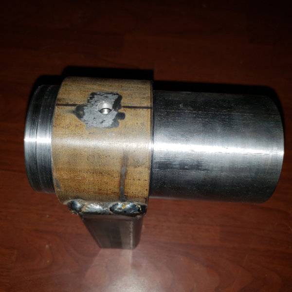

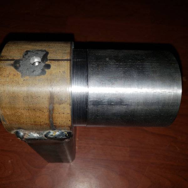

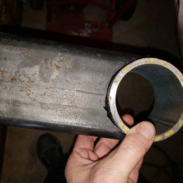

More work on the rotisserie . . . the "inner" tube dimension was just a little too big to fit inside the outer tube . . . so to the lathe . . .
First, I'll have to set up and get the picture of how the tube was trued to the 4x3 channel in the notch - but that's done . . .

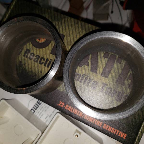

Now the milling of the inner tube has been completed and it's ready to go . . .
- you can see the milling marks on the left picture, and it can push up tight to the lip of the outer tube . . . works great . . .
Next step - to true up the up the "top assemblies" and get them welded onto the bottom assemblies . . . heading to the shop right now . . .

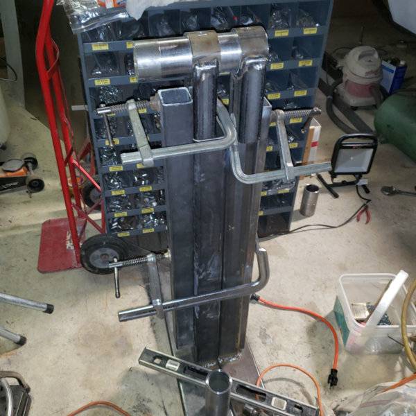

Then all of the braces are clamped together, and aligned, and then the "alignment tube is inserted through both upper supports . . .
- base of the brackets are checked for level - check
- alignment tube is put in place and make sure it spins - check ( this it how the gash got in my hand )
- make sue the tops to the brackets are level - was working on that . . .
- if all is good to go . . . tack in the corners of everything - double check level and tube spinning - then weld it all up !

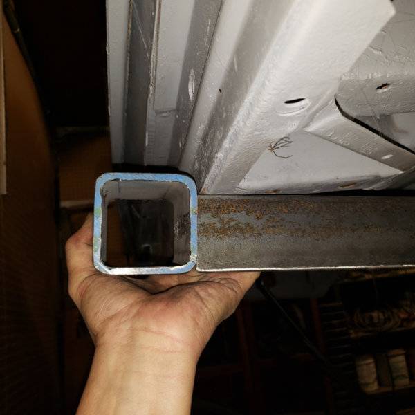

Decided that building it "adjustable" made much more sense than building it for just this car . . . so a quick trip to the steel place to pick up a couple pieces so that it can be built that way . . .

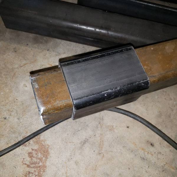

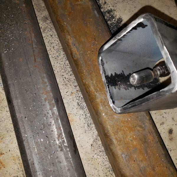

Been told that ( on paper ) a 1/4" wall 3" x 3" square tube "should" fit over a 2 1/2" x 2 1/2" square tube . . . so I picked up a piece of 1/4" - 3" x 3" to see . . .
First had to grind the weld out of the inside of the tube . . .
and guess what . . . it actually worked ( should I say IN THIS CASE ) . . . your results may vary . . .
The other 3" x 3" square I have is 3/16" . . . it'll have a little wiggle to it - got an idea for that too . . .

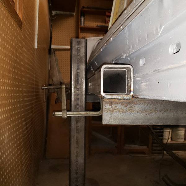

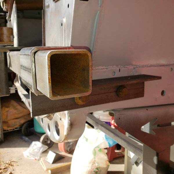

Next step was to decide how to make the brackets to bolt onto the car - first the rear brackets . . .
Plan A . . .
Plan B . . . ( not sure there is a "right way" or "wrong way", think they will both hold just fine . . . )
went with Plan A and welded up the Brackets - and then welded the angle on backwards from my original plan . . . so it'll still work . . .

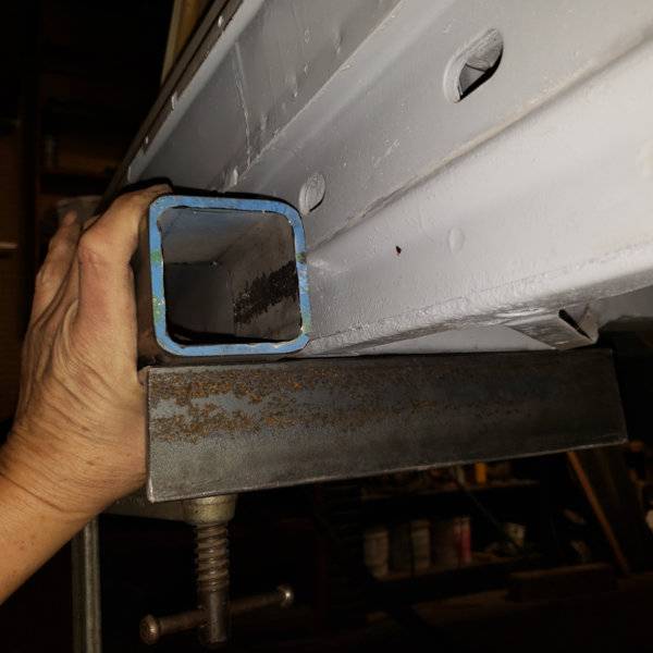

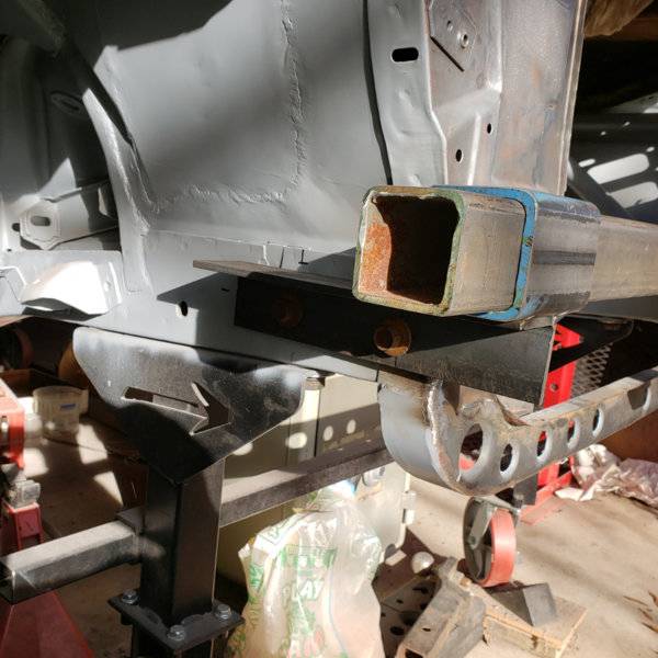

Next, the "hope" was that that my planning would make it tight to the car and not hit anything . . .
there is only about 1/8" clearance between the brackets and the car - something DID work out as planned ! ! !

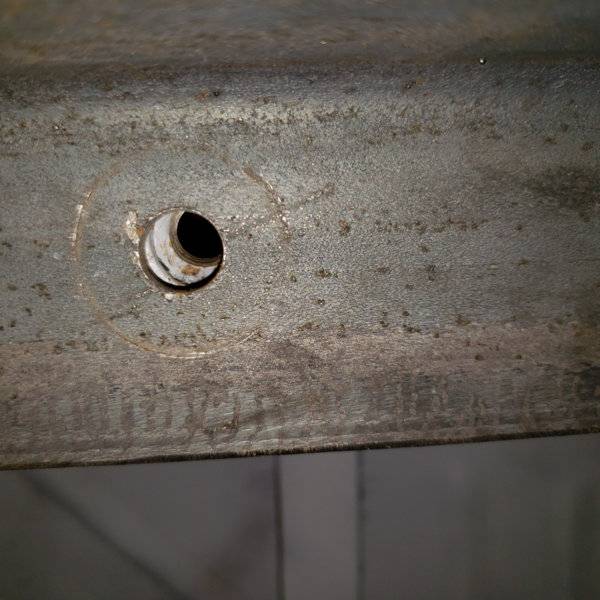

What was I thinking that the holes would be straight and at right angles to the new support bracket . . .
Time to get that fixed up - as needed . . .
