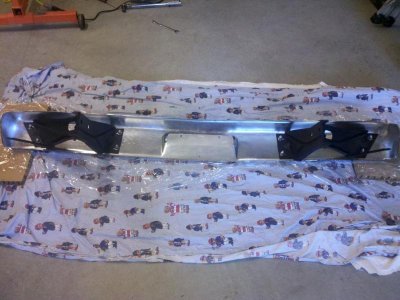

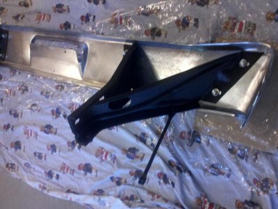

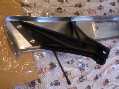

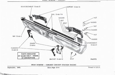

Anyone got pictures or exploded views of front and rear bumper brackets for 66 charger? Took them off several months ago and forgot how they go back on.
front1.jpgfront2.jpgfront3.jpgpics from 66 coronet front bumper if they help.
Awesome, thank you so much. The back bumper has a small plate for each bracket, do you know where the plates bolt to?
