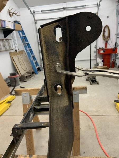

Find 71-72 brackets for the rears, or cut a section out of your originals and weld back up. For the front slot the mounting holes 1-1/2" to 2". I went 2" on mine.
You will also need to modify the front upper support brackets as they will be too long after tucking the bumper in.

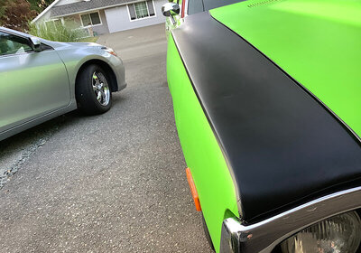

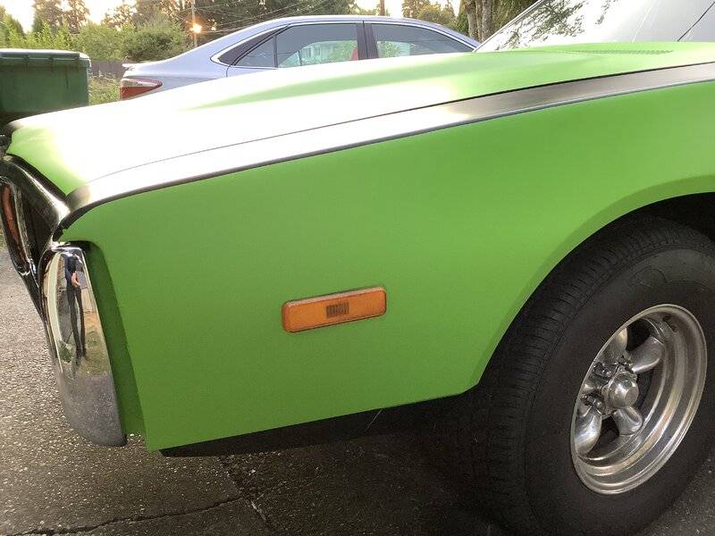

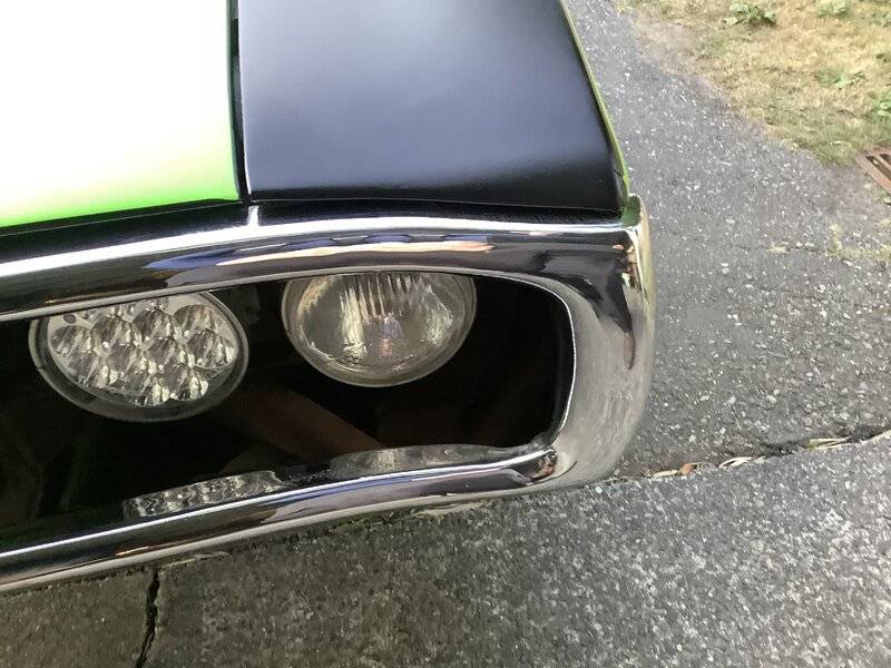

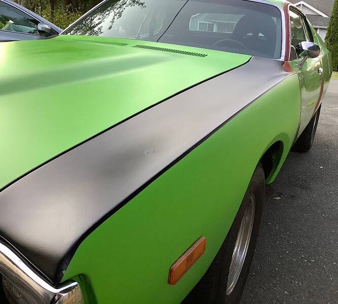

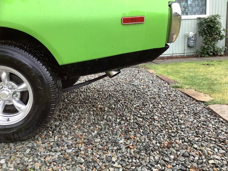

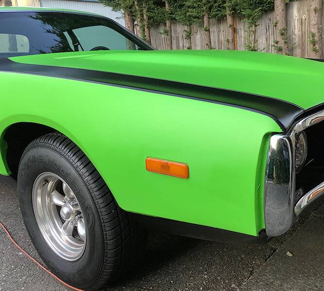

I have the same issue with my 74 road runner, I was planning on just making the end pieces out of fiberglass and the long center piece out of “L” channel. That is real far off as I’m currently replacing the fire wall. If you have three it might be worth your time and money to learn how to make a nice mold and produce some fiberglass pieces. Should be a video on YouTube to give you an idea how to do it. Nice looking car by the way.
I went with earlier bumpers and lots of people don’t realize that it’s a 74 until they look at the quarter glass. I removed all the badges as well to smooth things out. :luvplace:

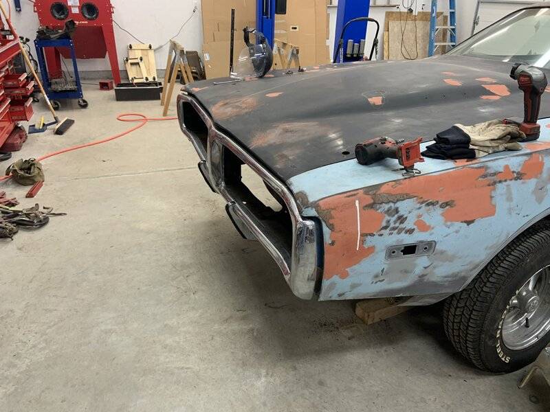

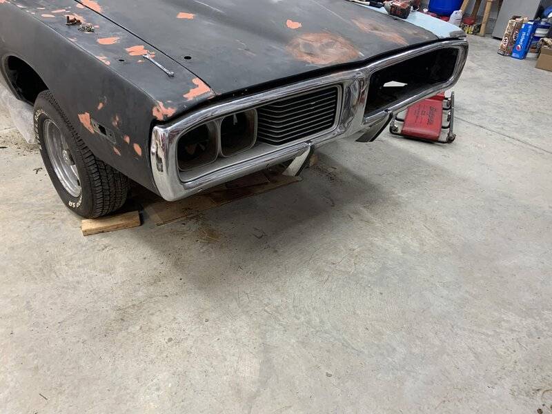

We have a member that tucked his 73/74 Plymouth bumper, but because the bumper is wider than the body, he also sectioned and re-chromed (or painted I forget) the bumper.
If you just "shorten" the mounts (they are at an angle, so it's not just a section and re-weld), the top will be tucked, but the sides will stick out and also interfere with the bottom of the quarter not to mention the valance.
