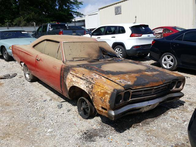

Just a heads up to anyone who may see this car for sale in the future. VIN is RM23H9A105595
https://www.copart.com/lot/38394630
At least the VIN plate rivets are in reasonable condition.
That ain’t buffing out!
I feel bad for the owner. THAT is why I replaced all the wiring in my car and do not push more power through the stock wiring AND I carry a large fire extinguisher. I'd be devastated if that happened to my car
Agree 110%. I think if that happened to me I'd be so pissed and let down I would sell the old **** and go buy a new Challenger and call it a day at that point. I always told the girlfriend if my garage burned down with cars in it, that is what I'd do because I'd be so let down/pissed.

Bulkhead connector looks ok but I have no idea about the condition behind the dash at the ammeter.
Is $24k estimate value worth it? Just asking not making a judgement
Looks like lots of damage
