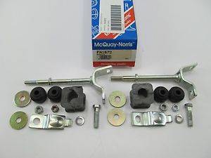

There's a slightly redesigned kt available on ebay.
Someone posted a link on another thread, possibly my rear bar bushing thread.

I looked at that kit, but it's supposed to be for the front bar, even though my front bar doesn't have anything that looks like that.

Bru- your pic is the redesigned one I was talking about.

Do you have those on the front bar of any of your cars? Mine doesn't, but all the listings I see for that part number show these are for the front bar and not the rear even though they damn sure look like the OEM parts. I'm wondering if this is another case of someone entering bad info into the database all the parts vendor uses.

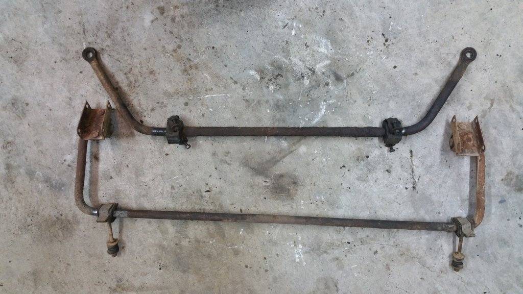

Im sorry, I completely forgot to send you a picture. Would any of these brackets help you out? The rubber is not good anymore but the links are still good.
