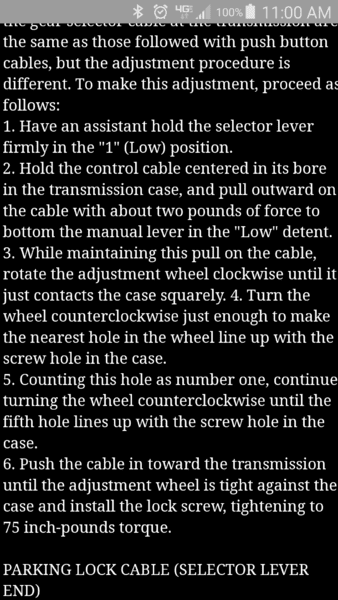

I got my 727 back from Pat Blais but wasn't 100% sure on the the shift cable adjustment. Currently I'm getting forward gears in N and R. It's a console shift '65 Satellite. I know that the wheel on the housing adjusts the shift points but wasn't sure on the correct procedure.
If you're in doubt about the adjustment, remove the NSS and look in the hole. The contact should be in the center of the hole in P and N.

Alright, so I adjusted it up and what do you know? I have N and R. I'm finding that I'm getting a bit of a shift flash (that's the best way I can think to describe it) on my 1-2 shift. I suppose this could also be a band adjustment issue.
