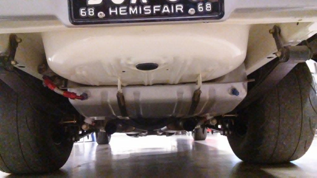

4 down works well for me. I run the ranchos Calvert sells. I struggled with my car for a bit at first but it's really nose heavy being an iron headed hemi. It worked well after I figured out what it liked.
I used the Calvert adjustable shocks alone with their mono-leaf springs. Like 68 Hemi GTS said, took awhile to get everything dialed in. Right spring is touching the front stop. Left is about 3/16" gapped. Shocks are set on #7.
