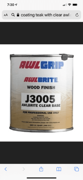

Clear Awl Grip has been used in the marine environment for decades on teak and mahogany. You can add a flattening agent if you want less shine. I’ve seen teak exposed to the sun and weather last 10 years before any lifting begins. Just a thought. Any clear epoxy that has a good UV stabilizer would possibly work also.
Good to know, I'll check it out.

I’ve lived on boats at least 10 years, any varnish had life of 2 years at best in the sun. People have been putting clear Awl Grip on teak and mahogany for years and years.
Varnish ten years ago ain’t nothing like 40 years ago, in fact NO paint is the same today as 40 years ago!
But some have gotten better, today you just have to research everything.

Interesting, epoxy is usually pretty tough stuff.
