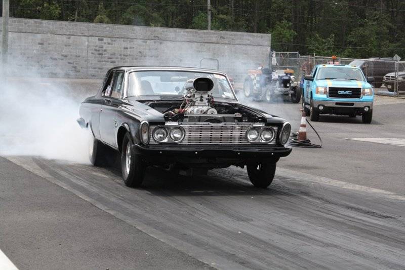

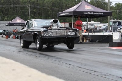

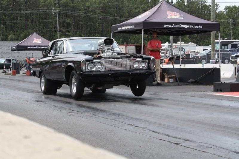

Cal Tracs,split mono's,sliders and Vikings.Been low 9,s @ 3700 lbs
