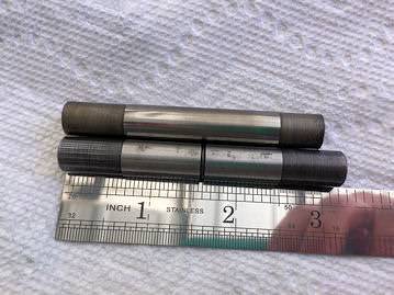

This one (top) didn't make any noise, about 1/4" wear...to the point the 440 would start but then starve after awhile.

Just got done with this, was starving for fuel. Replaced the pump with a Carter and the Shorty pump rod with a Comp unit. Hope the cam lives and had a slight noise from the pump area.
A worn down push rod could cause a knock for sure. But it could be the fuel pump itself. I had one on a 383 that the spring on the fuel pump was weak and not holding the rod tight to the cam lobe. Way better than a real rod knocking.
Edlebrock pump bronze tip rod comp cams decided to get another rod and check the length of the old to new then maybe run it for a sec with out the pump mounted to see if the noise is still there.
Must be the pump or something else, push rod was the same size as the new one, only difference was the old one had a beveled edge to it vs a flat edge on the new one. weird same part numbers on both. was a little quieter but I think it might be the edelbrock pump. just going to live with it until the pump fails
