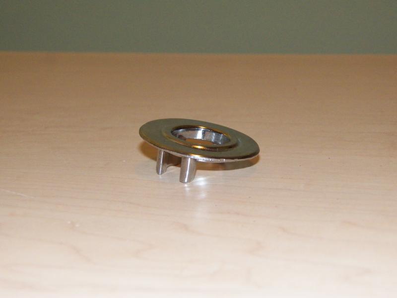

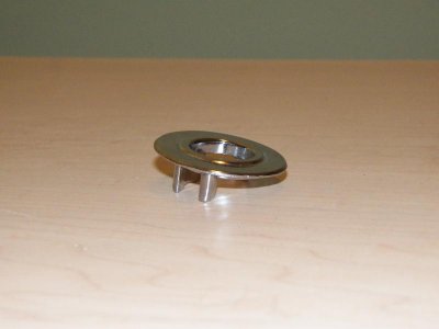

Can anyone tell me what models and years this antenna bezel fits? I can't seem to find anything by running the part number. The numbers on it are, from top left 4105 3513035 90332 3. Thanks in advance.

type the part number and description into your search engine..I found many results and photos....
3513035 is the Chrysler part number. Judging by the first two numbers, I'd almost think that it's 1972-4 vintage?
First, that number is a casting number.
Similar (1 or 2 digit off) numbers are listed 70-74. However I can tell you from the look of it, is not a 71-4 Charger. It is too flat. My guess is Sat/GTX.
Sorry. Not for 71-72 Satellite/Road Runner I have a 72 Satellite and it is way too flat. I couldn't figure out what the number sequence was, so it wouldn't bring up any results. I will try again with sequence mentioned above. Thanks again.
Day 4105 is Monday, October 23, 1972. Part # 3513035.
P 71-74 BELV, SATL 4D'S
3513042 is the part# for the P 71-74 BELV, SATL 2D'S
