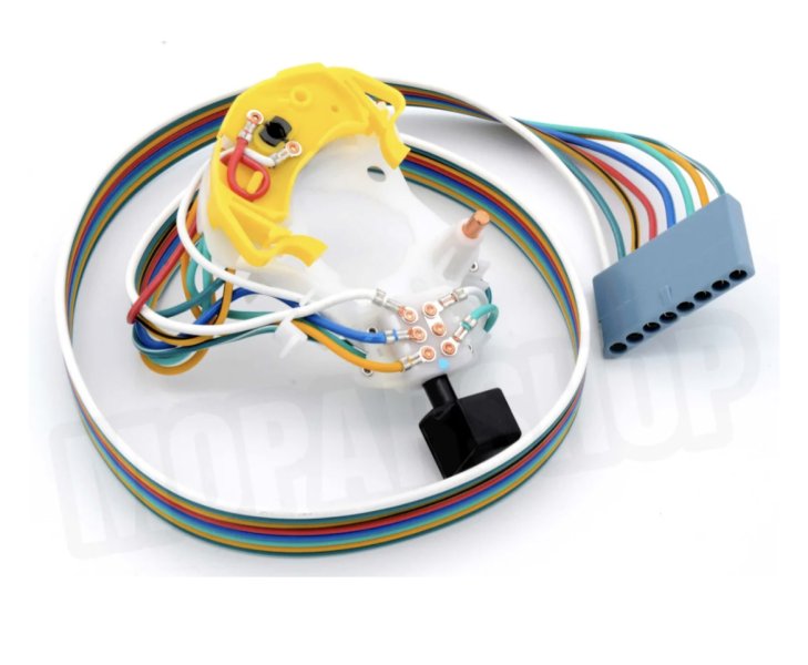

Hello, is there a wiring diagram for the cable terminal for the turn signal switch? I can't assign the colors because I have a newer wiring harness and the colors are different.
And in the manual, the colors do not match the smp blinker switch
Thanks for your help !

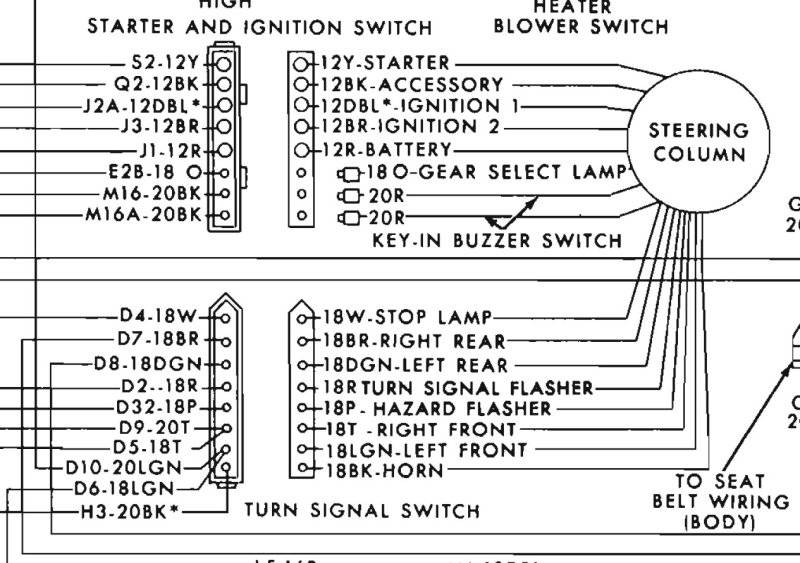

The FSM does in fact identify the original function and terminal position in the Molex. Should be able match it up with the aftermarket harness.
