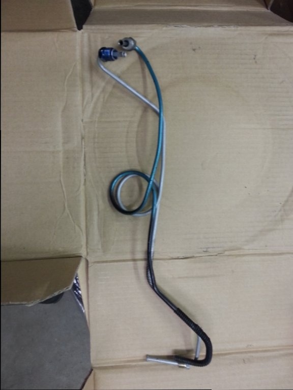

Decided to connect all lines to the proportioning block and test fit the master cylinder. The line for the front brake portion fits like a glove.

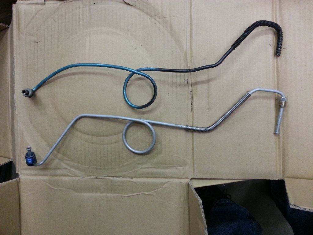

Spent quite a bit of time trying to figure out how the rear line can fit into the master cylinder. Then decided to compare to the original line; see pictures.
The fitting at the master cylinder would have to be bent and twisted to fit. Not sure I can do this without damage?
What are they steel? They looks sort of like anodized aluminum?
When I replaced the lines from the Master Cyl to the Proportion valve for my 72 Coronet I had to do a bit of bending. I screwed the line into the Master cyl then made the small adjustments I needed to get it to fit to the valve. I got mine from Mancini Racing
You can bend them easy,as said above, screw the fitting in the one that is a correct fit,then work the other end to fit.It will bend easily with out kinking.
