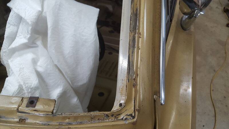

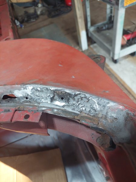

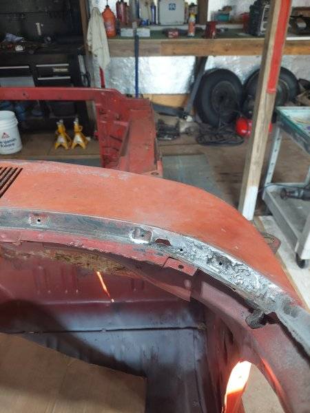

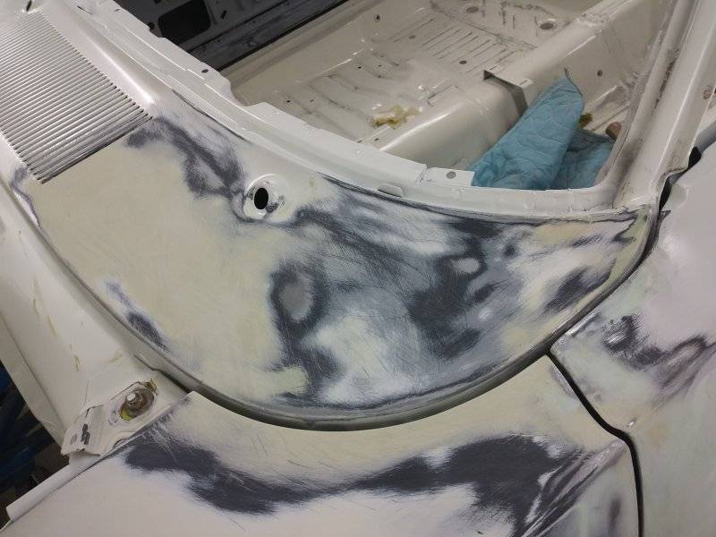

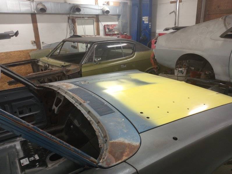

Looking for clean channel pics to compare to mine. Cleaning it and want to see mainly the lower and lower corners. Thanks pic not my car but what I want to see,down shot of corner

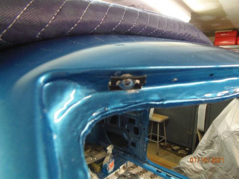

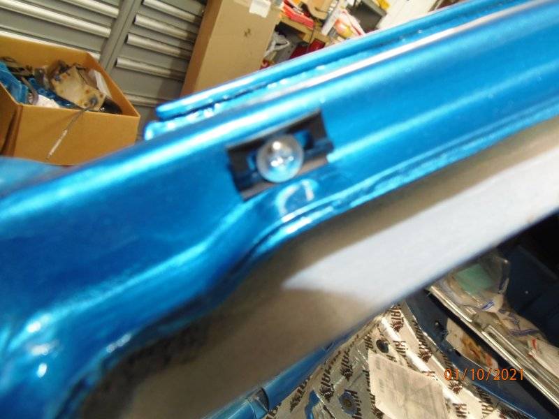

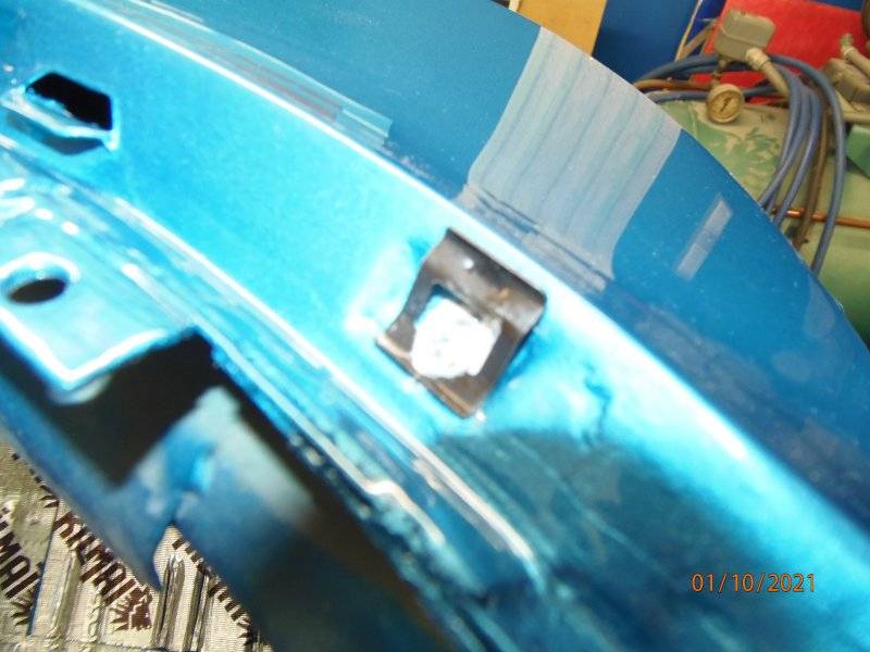

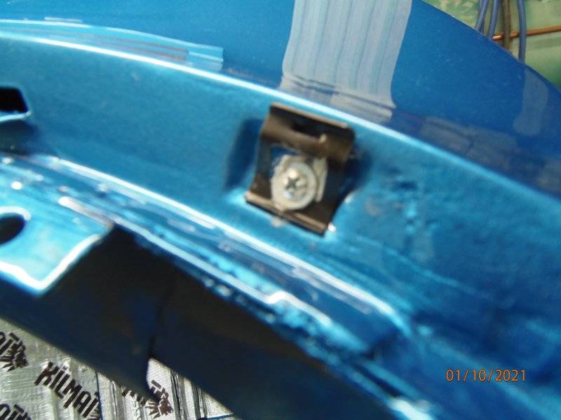

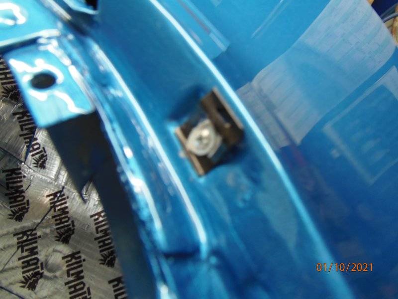

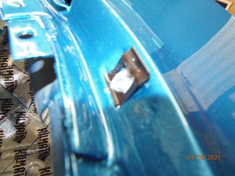

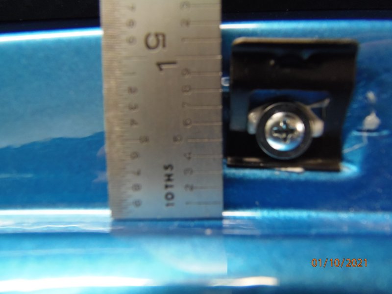

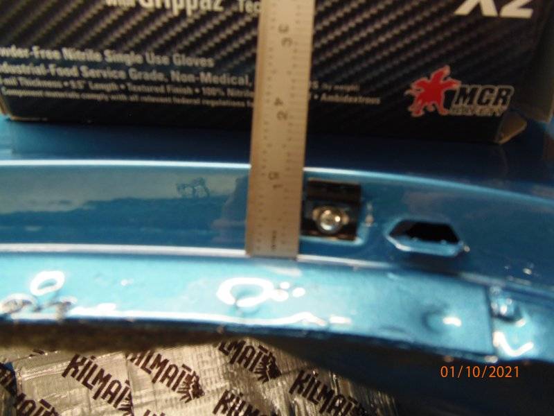

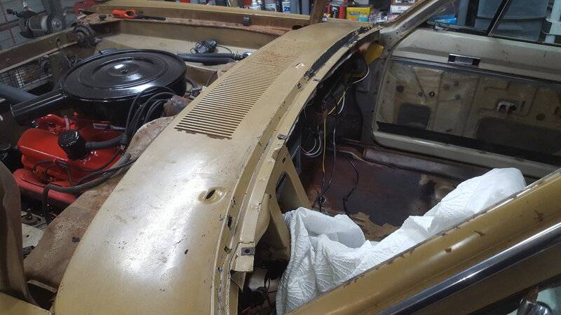

Mark,would you have a pic shooting down were the corner clip gos? I believe its like 3 inches from the a pillar.

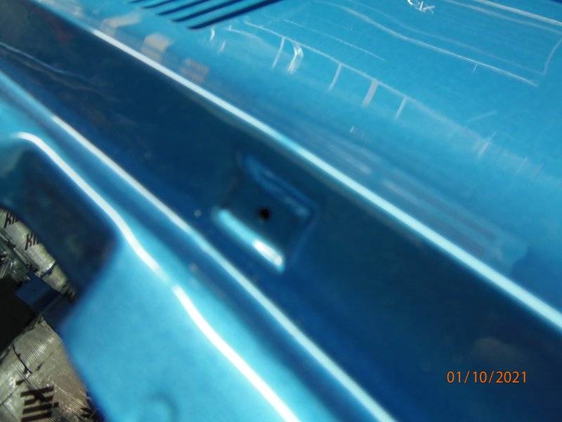

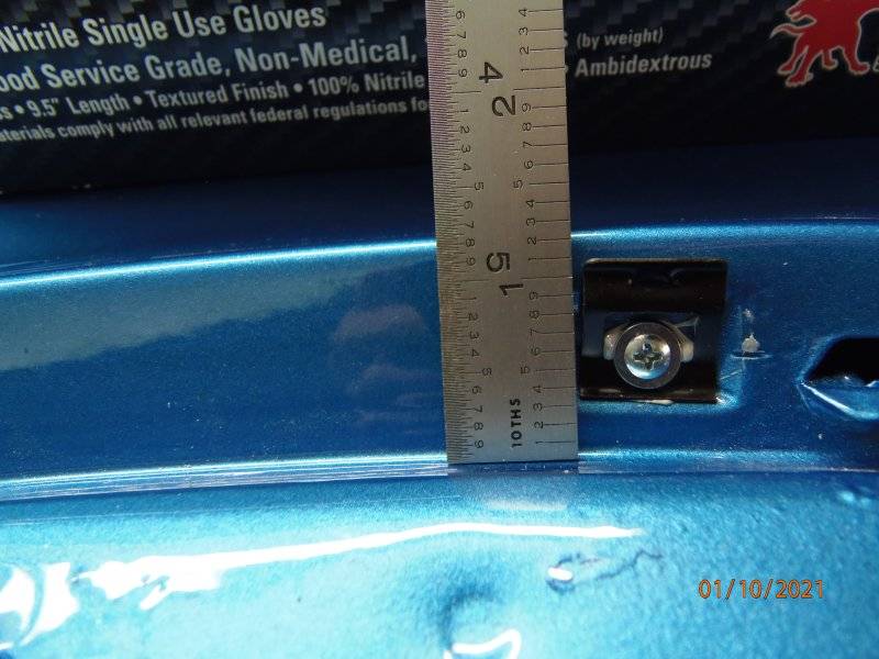

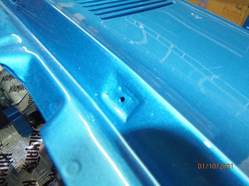

I can get a pic from my car tomorrow; it's the only B body here right now, and it's stuffed into my house garage surrounded with crap..... errr, stuff :rolleyes:
found the last 2 holes,total of 26 clips
