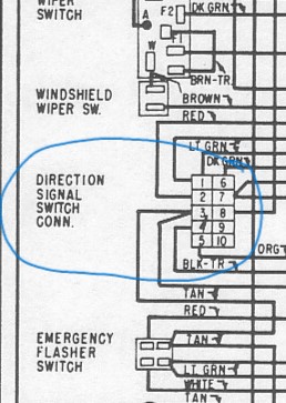

Thanks, I did print those out and look at them. Can I ask you something about electric diagrams:
I understand what the rectangular symbol with the lettering A-Z is- that's the bulkhead that passes wires from the interior to the engine bay. But what does the square/rectangular symbols 1-9 mean? Is that a splice? And if so, does it look like a plastic connector or is it just wires spliced and then wrapped in tape?

Thanks, do you know what the splice will look like? I mean, is it a plastic junction connector or something? or is it just 3-4 wires twisted together and then taped up? Assuming it's untouched from the factory I mean.

9th symbol down on the right side is the splice symbol. If you are talking about the rectangle on the A drawing that's numbered 1 through 10 that is the connector for the turn signal switch. Last picture in this set shows the Turn signal connector for the switch.
BeepBeepRR, thanks so much for doing that for me. This is really helpful. The splice I'm showing on my diagrams does not have any numbered squares, it just looks like the splice symbol in the chart, so I guess I'm not looking for a plastic type connection but rather wires taped together.
