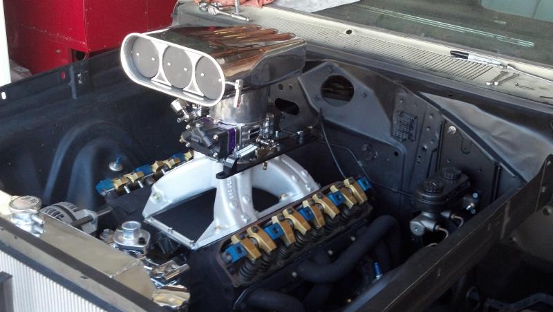

my fuel guy likes em(billet)because he can get a much nicer finish on the inside when customising them. 2012-06-06_15-03-53_673.jpg
