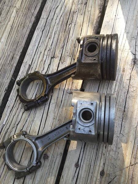

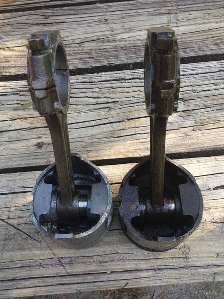

These pistons were from a 1964 413 and the oven cleaner dissolved the fossilized grease and carbon in areas that couldn't be reached with any kind of brush .
