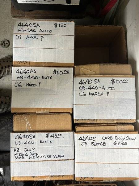

I have a few if you’re interested I’ll take pictures of them.
As I understand Cater 2 digit date codes, you have a carb body from Oct of 1968, the others appear to be April 1971, and a couple from March 66 or 76? Am I misreading these?
that would be my thoughts also, looking at the part# cross reference charts it looks like this # is a 68-69 only carb though. I'm curious if anyone knows the meaning of the SA as opposed to the S, could that be an over the counter replacement or ?? I don't have anything to offer you but, I'm also hunting a specific dated carter carb and I'm trying to better understand.

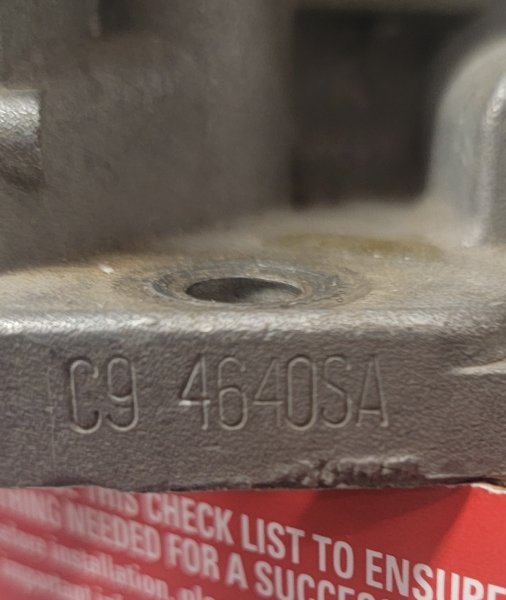

I've been doing a little digging around on the SA/A difference and I think you are correct that the SA is a service replacement, and an S is a assembly line carb
Yes, correct, so, the carb that he should be looking for is a 4640S, as the SA will never have a correct date that he is looking for. ALL the SA date codes will be after the 1969 production year, some by several years.
