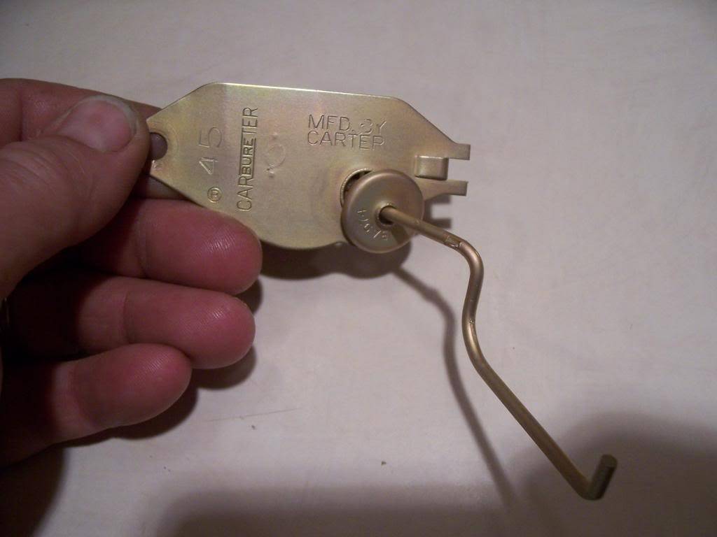

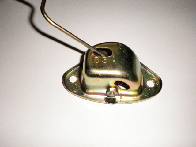

I am getting some parts plated and was wondering if anyone knows the correct way to have my Carter 45 Choke Assembly plated. Should the entire part be Zinc W/ Yellow Dichromate or are some of the pieces Clear Zinc? Looking at some pics the rod and circle plate on top might be clear zinc but I can not tell for sure.
Everything yellow,same as a 53..

This is how ours looked only a lot duller before we had it plated. Pic is after it was plated.
OK Thanks very much. Both look like they came out great
