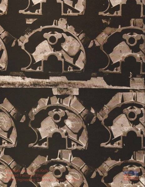

Could have been mid 67, who knows. Cast, cast, cast.. stack, stack, stack. Last in was the first out most likely.

Yep, LIFO. (Last in, first out) they didn't rotate their inventory like they do at the grocery store. Could be a few weeks to a few months prior to the assembly date.
I believe there are a few things that factor in here…. The cast, cast, cast-stack, stack, stack certainly plays a part. Worked in an iron foundry, seen this first hand. Don’t get too caught up in casting dates on blocks. Pay more attention to the engine’s assembly date stamped into the engine block for the appropriate model year. Unless a block has been restamped, I guarantee the casting date will precede the assembly date. So it seems the time window between engine assembly and scheduled production date would matter most for a ‘correct dated cylinder block’.

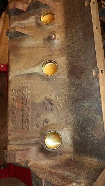

Here's one with a 13 month difference.
