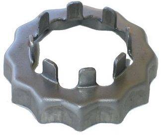

My car didn't use either type of castle nut. Instead, a regular nut was capped with a stamped retainer that allowed far more adjustment for tightening - instead of just to the nearest 1/6 of a turn.
That nut lock is for the spindle nuts.
