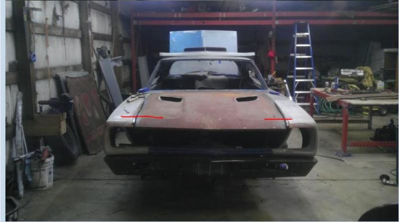

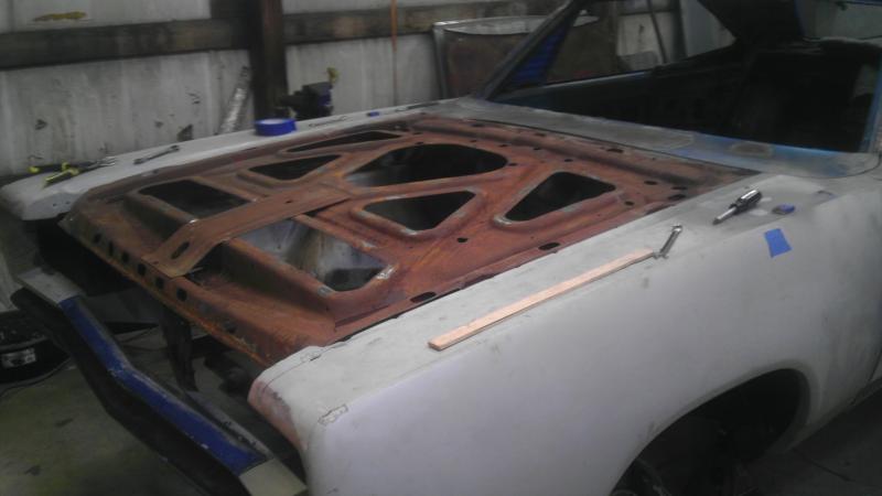

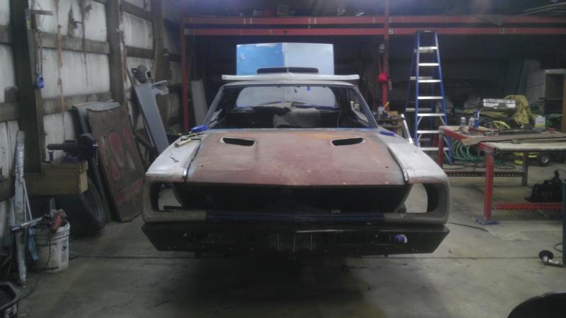

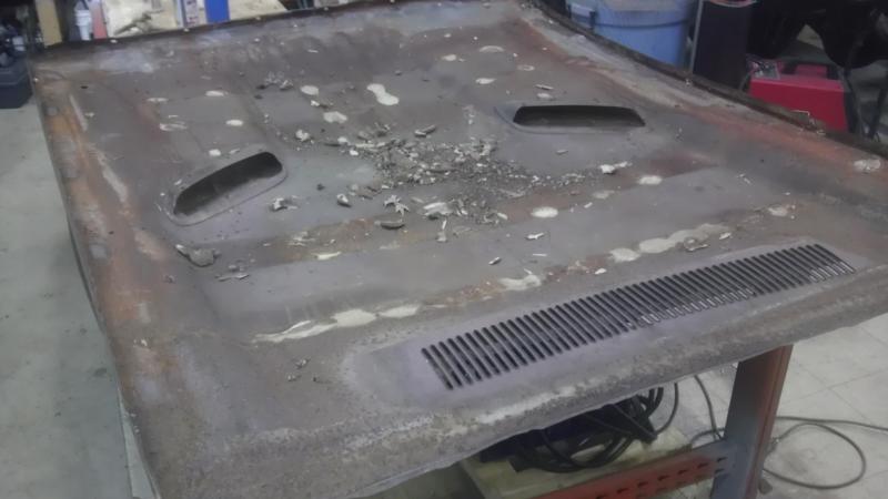

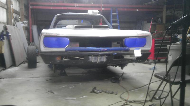

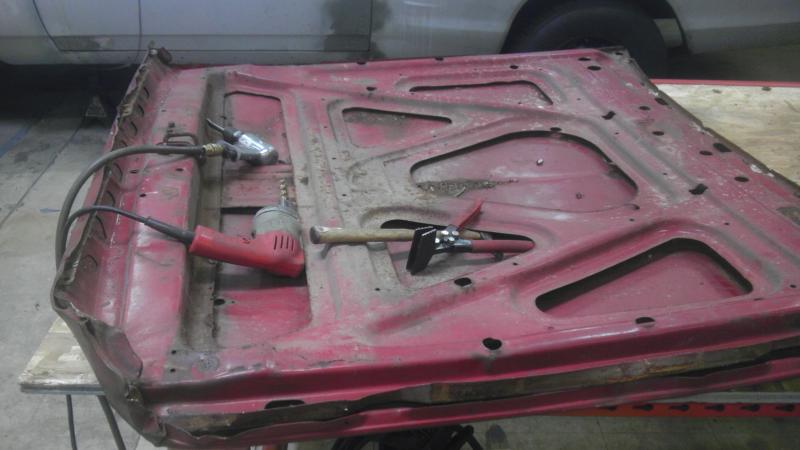

So..I had this crazy idea today to put a 70 something challenger rallye hood on my 68 Coronet.
I had a 67 Plymouth satellite hood I used for the bracing frame. And a rallye hood I started to skin it with. Both hoods I had laying around and were not in good shape so don't worry I didn't cut up good parts. Check it out, I just what some input, rallye or 6-pack hood I had on it? Btw, the headlights are cut out to fit the 2012 challenger grill and headlights.
I think it's gonna be cool !!!
I can see the hood and fender accent line similarity that you may or may not be going after but I think it's gonna be cool if you can realize your vision
Like I said I wanna see it completed !

Yea the hood to fender body lines are spot on. The nose will need to be rounded to match the fenders. Front width needs sectioned, rear is close. I cut about 6" of the back end to fit. Its just a rough draft pic pretty much still trying to see if I like it. The front end is fiberglass and I like the 6-pack for the 440 I got, but now I want a 6.1 or 6.4 and since the 6-pack isn't functional really on that I was looking for something different. Thanks for the input, love or hate no offence taken.

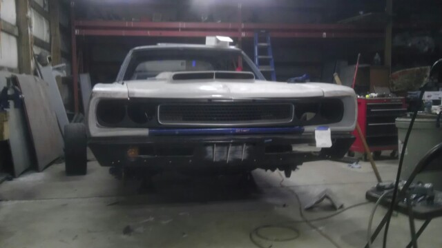

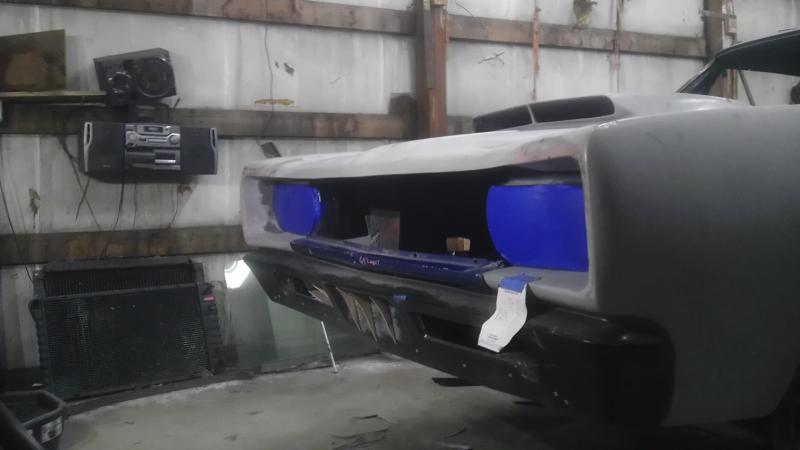

TBM are just my initials. I do plan on having the front edge match the stock Coronets hood. I will make it out of flat 20ga sheet and graft to on. I am not cutting on my stock 68 RT hood that's for sure. The headlights are fitted and grille needs trimmed and mounted. But I can get a mock up pic soon. I am waiting on an electrician to add another 230v plug to the shop to plug in my new Lincoln 175 TIG to make the mounts out of aluminum. The car is a coupe no post RT clone originally a 318 car that was rusty so I don't feel bad about cutting it up.
I did find these pics of the front so you get an idea. I think the grille is killer
